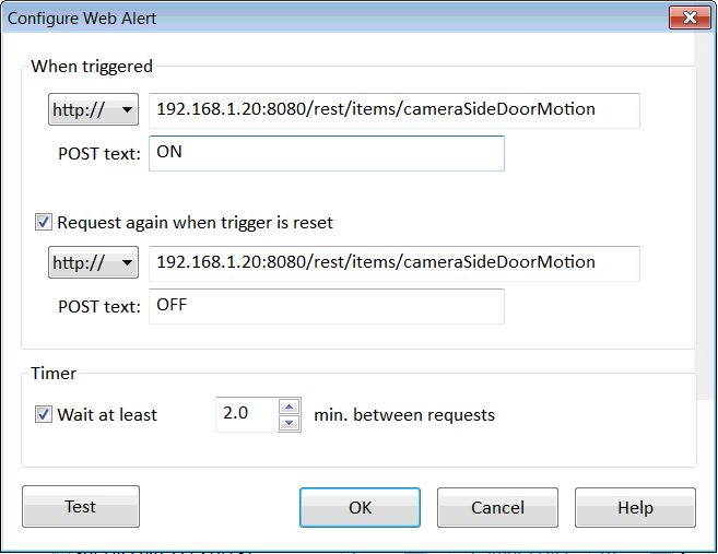

In Blue Iris, go into the alerts tab for a camera, open the the Configure Web Alert screen you have pasted, and enter the following:
When Triggered
192.168.1.100:8080/CMD?MotionSensorItem=ON
Check off “Request again when trigger is reset” (turn off motion sensor)
192.168.1.100:8080/CMD?MotionSensorItem=OFF

You can also use the official REST API, but you need to fill POST data.

I don’t know if this addresses any latency concerns, but I’ve changed my camera web alert settings to the attached pic and the trigger happens instantly.
Thanks for the feedback. In the process of upgrading 1.8 to 2.1. I entered the new RESTAPI and it works. It is still taking 6 sec for Blue Iris / OpenHab to update the motion switch. Too slow for turning lights on.
