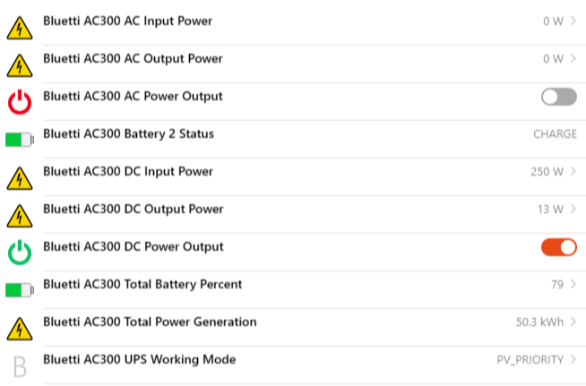

At this point, I installed MQTT Explorer on my PC and pointed it to the server. I could see my data coming in from the Bluetti.
After a reboot, it found my Bluetti AC300 in things. I configured all my items.
Power From Solar Panels. The sharp cutoff was when the battery was full.
I used a Label Cell to display these on my Overview Page.
