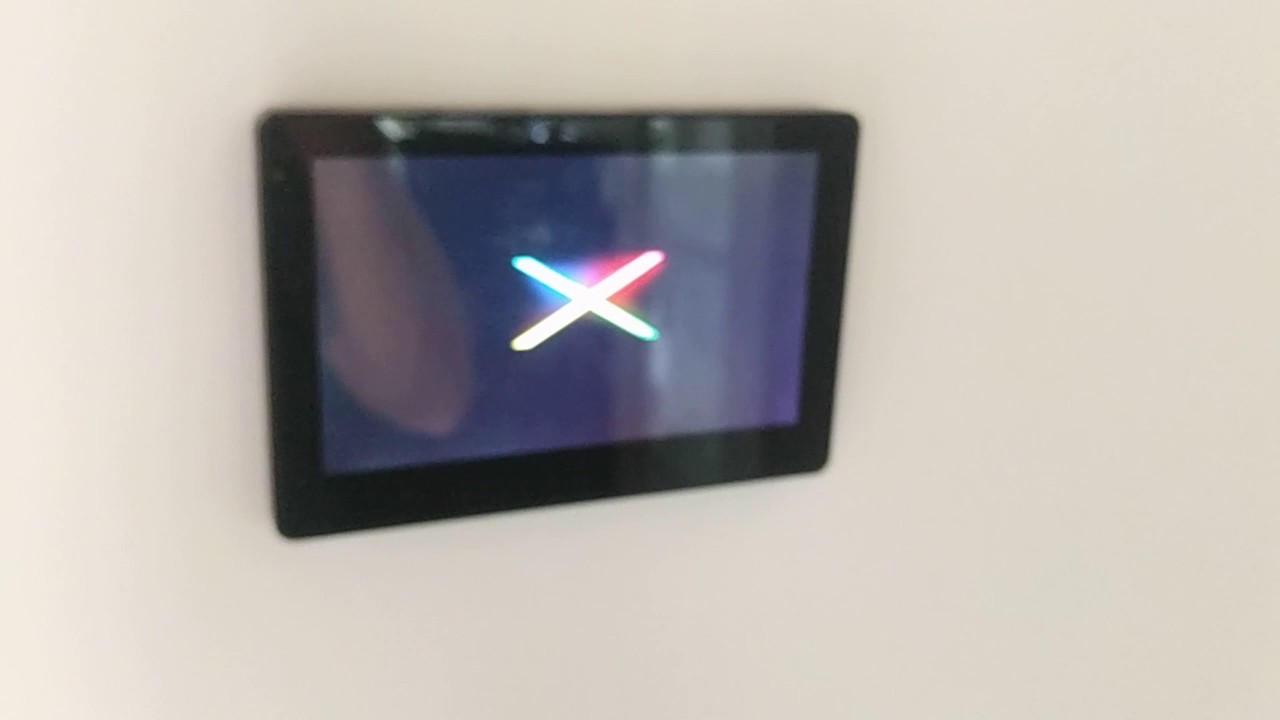

This gets you this point (note that you can make the corner home/back buttons fully transparent I just did not do that on this panel yet)

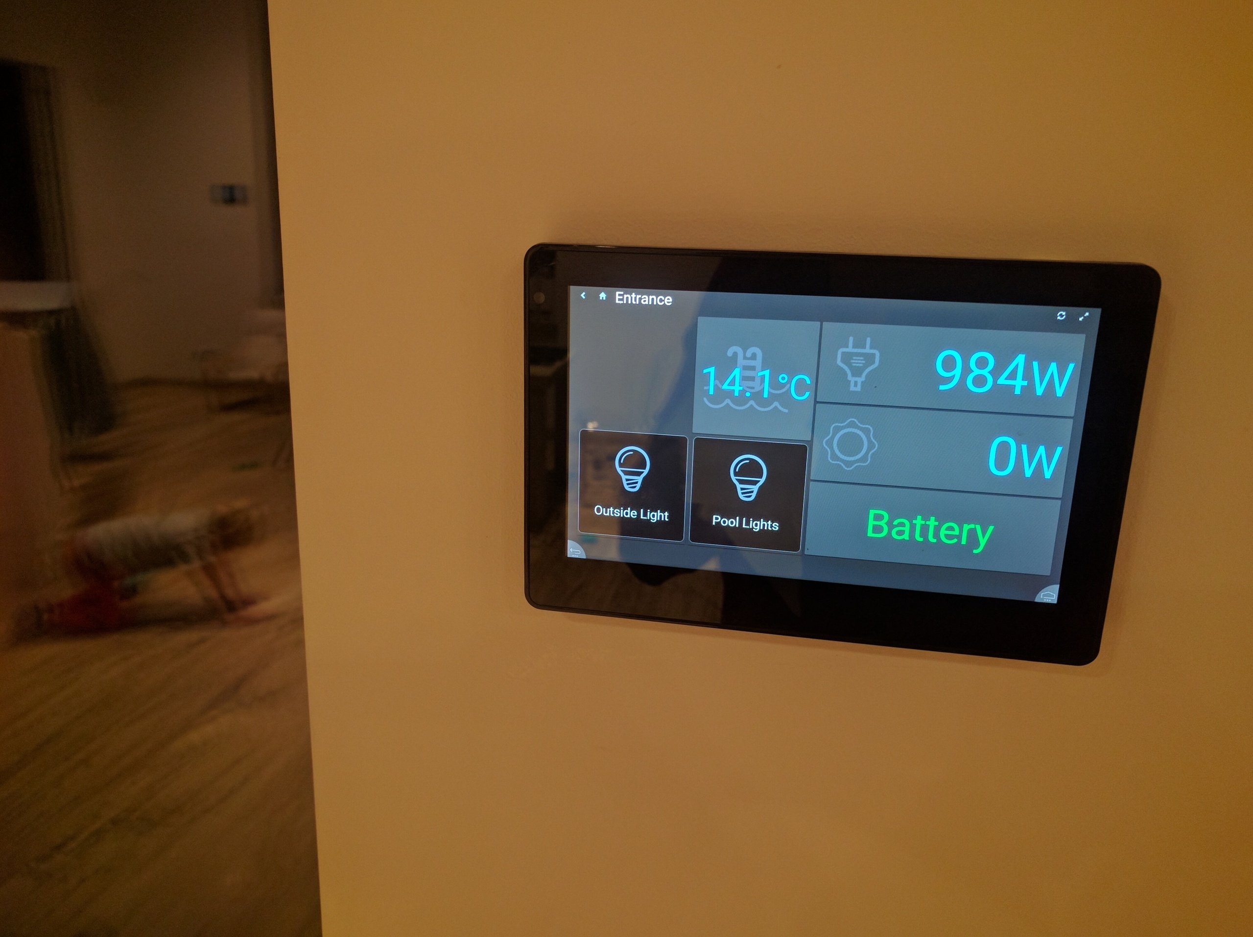

Ok does work on 574. It look I was to quick checking it out. Looks fantastic. I now achived exactly what I wanted with fully automated boot into the HABpanel without the OS toolbars.
kiosk=on does remove the top navigation bar so I think I will do there a small custom template with the name of the panel and a clock and maybe room temp

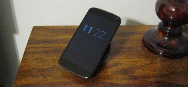

I use the “daydream” feature in Android (recently renamed by Google because the reused the name for virtual reality stuff)
You can display a clock in “night mode” which turns the brightness all the way down. But I don’t use the native clock, I use Timely from http://www.bitspin.ch/.
