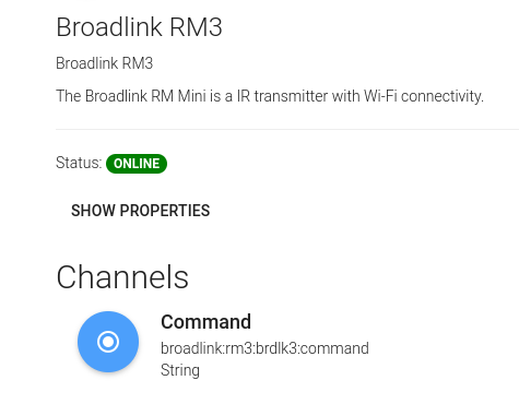

Hi everyone, I’m new around here and new to openhab too, but amazed of what you could realize with it.
Last year i bought a RM mini 3 always used with his app, worked like a charm, now that I discovered OH I’d like to integrate with it, but I’m facing some problem:
I installed the binding, and followed the steps to get it working, but I got stucked in the channel linking:
no channel is associated with the broadlink item:
I’m using Paper UI and OH 2.4 stable, these are my config files:
broadlink.items:
String AIR “Air” { channel=“broadlink:rm3:brdlk3:command” }
default.sitemap:
sitemap default label=“Test sitemaps” {
Switch item=AIR label=“Power” mappings=[AIR_ON=“On”,AIR_OFF=“Off”]
transform/broadlink.map:
AIR_ON=26005002100C100D0F0D0F0E0F0D0F00033973371029100D0F0D100D0F2A0F0D100D0F0D100D0F2A0F0D0F2A0F2A0F0D10291029102910290F2A0F0E0F0D0F2A0F0D100D0F0D100D0F0D100D0F0D0F0E0F0D0F0E0F29100D0F2A0F0D100D0F0D102910290F0E0F0D0F0E0F0D0F2A0F0D100D0F0D100D0F0D100D0F0D100D0F0D0F0E0F0D0F2A0F2A0F2A0F0D100D0F2A0F2A0F2A0F00048E73380F2A0F0D0F0D100D0F2A0F0D100D0F0D100D0F2A0F0D0F2A0F2A0F0D102910291029102910290F0E0F0D0F2A0F0D100D0F0D100D0F0D100D0F0D100D0F0D100D0F0D0F2A0F0D100D0F0D100D0F2A0F0D100D0F0D100D0F2A0F29100D0F2A0F2A0F0D100D0F0D10290F0E0F0D0F0E0F0D0F0D100D0F2A0F0D10291029100D0F0D0F00048E733810290F0E0F0D0F0E0F29100D0F0D100D0F0D1029100D0F2A0F2A0F0D0F2A0F2A0F2A0F2A0F2A0F0D100D0F2A0F0D0F0D100D0F0D100D0F0D100D0F0D100D0F0D100D0F0D0F0E0F0D0F0E0F0D0F0D100D0F2A0F0D100D0F2A0F0D100D0F2A0F0D0F0D100D0F0D100D0F2A0F2A0F0D100D0F0D0F0E0F0D0F0E0F0D0F0D100D0F0D100D0F0D100D0F0D1029100D0F2A0F0D0F0E0F0D0F0D100D0F0D100D0F0D100D0F0D100D0F0D100D0F0D0F0E0F0D0F0D100D0F2A0F2A0F0D100D0F0D100D0F0D0F0E0F0D0F0E0F0D0F0D10291029100D0F0D100D0F0D100D0F0D0F0E0F0D0F0D100D0F0D100D0F0D100D0F0D100D0F0D10290F0E0F0D0F0E0F0D0F0D10291029100D0F0D100D0F0D100D0F0D0F0E0F29100D0F0D100D0F0D100D0F0D100D0F0D100D0F2A0F0D0F0E0F0D0F0D100D0F2A0F000D050000000000000000
AIR_OFF=26005002100C100D0F0D100D0F0D1000033873380F2A0F0D0F0E0F0D0F2A0F0D100D0F0D100D0F2A0F0D102910290F0E0F291029102910291029100D0F0D0F2A0F0E0F0D0F0D100D0F0D100D0F0D100D0F0D100D0F2A0F0D0F2A0F0D100D0F0D10291029100D0F0D100D0F0D0F2A0F0E0F0D0F0D100D0F0D100D0F0D100D0F0D100D0F0D10290F2A0F2A0F0D100D0F2A0F2A0F2A0F00048E73380F2A0F0D100D0F0D0F2A0F0D100D0F0D100D0F2A0F0D102910290F0E0F291029102910291029100D0F0D10290F0E0F0D0F0D100D0F0D100D0F0D100D0F0D100D0F0D10290F0E0F0D0F0E0F0D0F2A0F0D10291029100D0F2A0F2A0F0D0F2A0F2A0F0D100D0F0D1029100D0F0D0F0E0F0D0F2A0F2A0F2A0F0D10291029100D0F0D0F00048E73380F2A0F0E0F0D0F0E0F29100D0F0D100D0F0D1029100D0F2A0F29100D0F2A0F2A0F2A0F2A0F2A0F0D0F0E0F29100D0F0D100D0F0D100D0F0D100D0F0D100D0F0D100D0F0D0F0E0F0D0F0D100D0F0D100D0F0D100D0F0D1029100D0F0D0F2A0F0D100D0F0D100D0F0D10291029100D0F0D100D0F0D0F0E0F0D0F0D100D0F0D100D0F0D100D0F0D100D0F2A0F0D10290F0D100D0F0D100D0F0D100D0F0D100D0F0D100D0F0D100D0F0D0F0E0F0D0F0D100D0F0D10291029100D0F0D100D0F0D0F0E0F0D0F0E0F0D0F0D100D0F2A0F2A0F0D100D0F0D100D0F0D0F0E0F0D0F0D100D0F0D100D0F0D100D0F0D100D0F0D100D0F2A0F0D0F0E0F0D0F0D100D0F2A0F2A0F0D100D0F0D100D0F0D0F0E0F0D0F2A0F0D100D0F0D100D0F0D100D0F0D100D0F2A0F0D0F0E0F0D0F0D100D0F0D102910000D050000000000000000
I really don’t understand why it doesn’t work. Any help will be appreciated.
Hi @BundleBee - did you forget to post your rule file or is this the bit you are missing?
Hi @Andrew_Pawelski, I don’t have any rule file, it wasn’t mentioned in the installation post :thinking:
