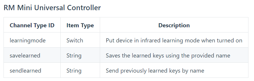

The documentation shows three channels.
I haven’t done this, but I assume the steps are:
  1. Make an item for each channel
  2. Toggle the learningmode switch to ON to teach a code to the RM Mini
  3. Copy the IR code from the savelearned string item in your log
  4. Use the IR code to the sendlearned string item to trigger the command
Since you already have the IR codes, you should be able to skip steps 2 and 3. I’m just including them here to cover the whole process.
If this works, please confirm for the benefit of other users.

I don’t understand what they mean in the documentation with “saves the learned keys with the provided name” No idea what is meant here how to provide that name in the config before. Anyone has a best guess?

You’ve already learned the code, so as I understand it you would now send a command to the saveLearned item with the name you want to give the code, and the binding will store it.
Then you would send commands to sendLearned using the name.
Seems a little more complicated, but that could just be due to my lack of familiarity with it. At the very least, this method doesn’t require users to read the IR codes or use map transformations.

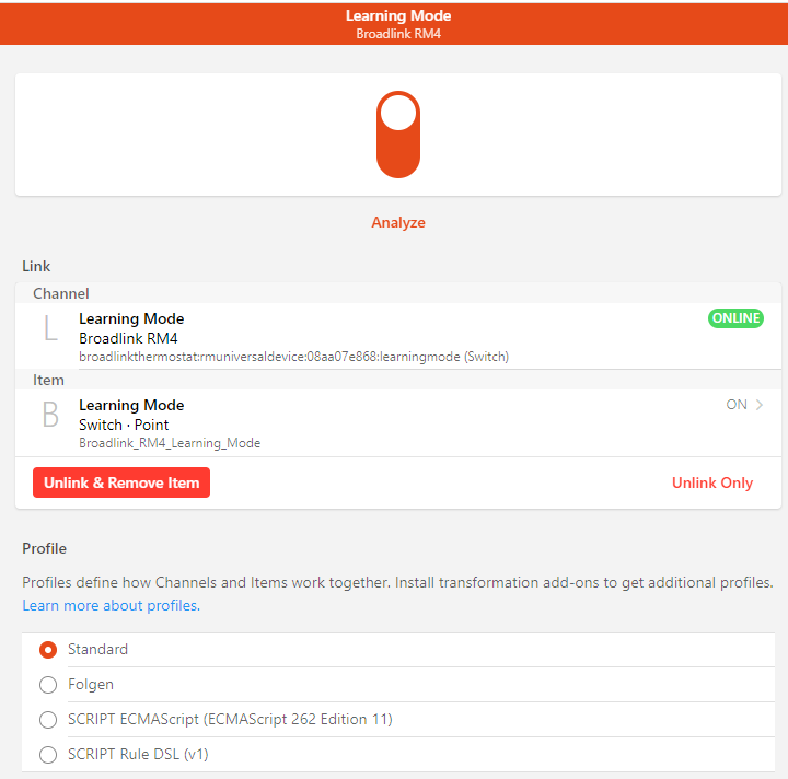

Hello.. I have played a little with the soultion now.
But so far I’m NOT able to bring the RM4 mini to the learning mode, when
switching “on” the switch in the Learningmode and sending to the RM4 mini via IR from the remote
a code. The LED on the RM4 mini in NOT go be “white”. no nothing happend on it.
The RM4 mini works perfect with the old unoffical binding in 2.5 - 3.4.4. and also in 4.0.x version.
So the HW is not broken and it working finde to switch my clima on and off.
Only the new binding will not run with it.
PS: The RM4 mini I can ping etc…
UID: broadlinkthermostat:rmuniversaldevice:08aa07e868
label: Broadlink RM4
thingTypeUID: broadlinkthermostat:rmuniversaldevice
configuration:
  host: 192.168.1.49
  macAddress: 24:df:a7:e8:41:30
channels:
  - id: learningmode
    channelTypeUID: broadlinkthermostat:learningmode
    label: Learning Mode
    description: Put device in infrared learning mode when turned on
    configuration: {}
  - id: savelearned
    channelTypeUID: broadlinkthermostat:savelearned
    label: Save Learned
    description: Saves the learned keys using the provided name.
    configuration: {}
  - id: sendlearned
    channelTypeUID: broadlinkthermostat:sendlearned
    label: Send Learned
    description: Send previously learned keys by name.
    configuration: {}
What can I do more to bring the RM4 mini to work?
I found now a settings in the binding itself, were I can enable the logging . This is now the logfile when press the switch to the learing mode:
2023-09-19 07:57:10.639 [DEBUG] [nal.handler.RMUniversalRemoteHandler] - Command: ON
2023-09-19 07:57:10.641 [DEBUG] [nternal.handler.BroadlinkBaseHandler] - Authenticating with broadlink device Broadlink RM4...
2023-09-19 07:57:10.669 [WARN ] [com.github.mob41.blapi.BLDevice     ] - RM2 enter learning received error: fffffffb / -5
2023-09-19 07:57:10.671 [DEBUG] [nal.handler.RMUniversalRemoteHandler] - Thing broadlinkthermostat:rmuniversaldevice:08aa07e868 entered learning mode
2023-09-19 07:57:10.612 [INFO ] [openhab.event.ItemCommandEvent      ] - Item 'Broadlink_RM4_Learning_Mode' received command ON
2023-09-19 07:57:10.621 [INFO ] [penhab.event.ItemStatePredictedEvent] - Item 'Broadlink_RM4_Learning_Mode' predicted to become ON
2023-09-19 07:57:10.622 [INFO ] [openhab.event.ItemStateChangedEvent ] - Item 'Broadlink_RM4_Learning_Mode' changed from OFF to ON
