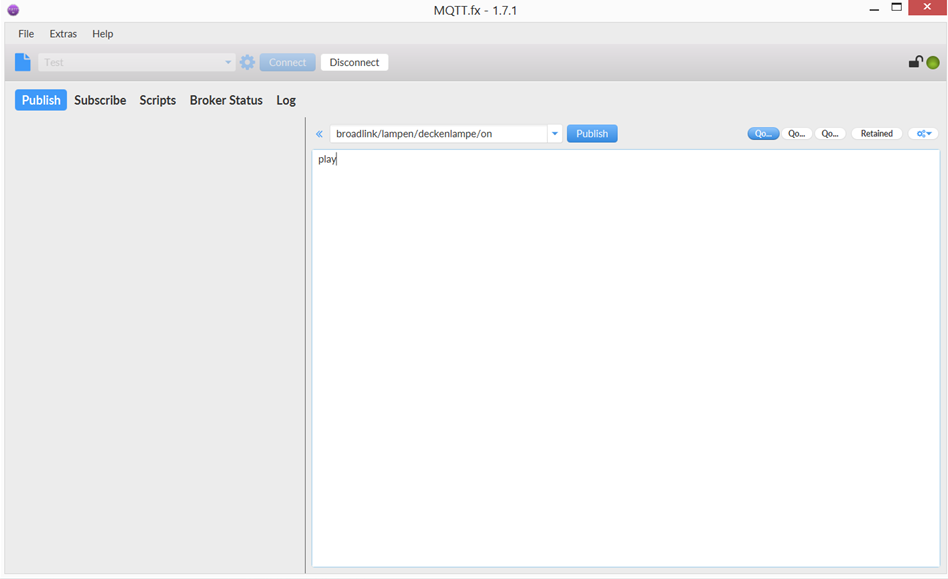

    So now my question, when I put tihs into my mqtt.fx:
    It works fine.
    So what I have to do write in the Channel under " MQTT State Topic" and in “MQTT Command Topic”?
    When the channel is a Switch.
This forum is about openHAB. And openHAB bindings.
You should know what MQTT state and MQTT command topics are. This is MQTT specific.
A hint: openHAB will publish to command topics and will receive and assign new states from state topics.
If you knew this already and think that the binding docu should be improved, please help and propose a change.
