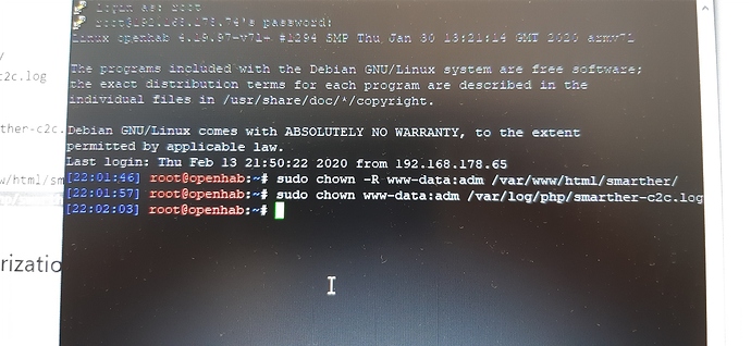

sudo chown www-data:adm /var/log/php/smarther-c2c.log
you tell me in ect first , now need do other equal in www , but i need root and no know do
can tell me i admin root rasperry
login with openhabian then:
sudo passwd root
and give whatever password you want. Logout and login with user: root and the given password

i go in putty, /var/www/html/smarther/smarther-api.sh see link , copy link in firefox , enter and see this : {
“error”: “server_error”,
“error_description”: “An unexpected server error occurred”
Have you registered the application on the Legrand Website and entered the correct reply url? 192.168.178.74…etc
