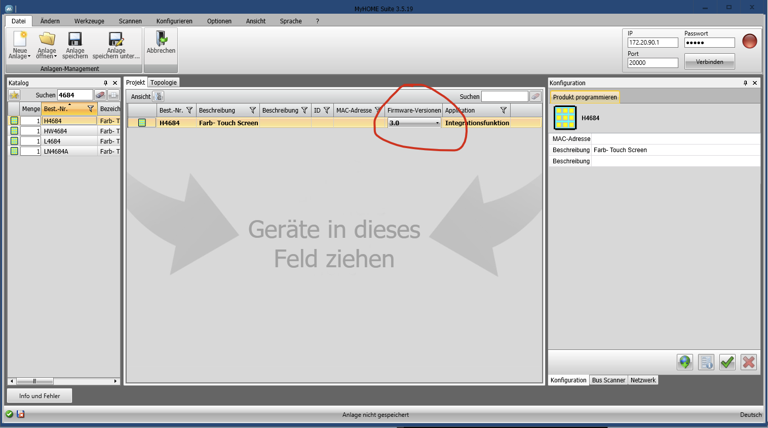

as far as i know you can either use myhome suite to configure or the myhome server (this is the new kind of configuring).
i do not have a myhome server, i work with the myhome suite and have configured my mh200n as a gateway (also other devices are possible).
i do not know your 4684, but i see in myhomesuite you can “change” the setup to your firmware, see pic.
That looks very interesting, thanks a lot. I will try the MyHome Suite then. Not sure though if my 4684 can act as gateway though, but first I have to see if I can use the MyHome Suite to connect to the 4684 via USB and configure it to even talk to the Ethernet.
