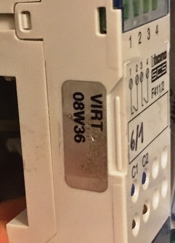

Here is where I could find the production batch on my devices:
Actuator F411-2 Left Side

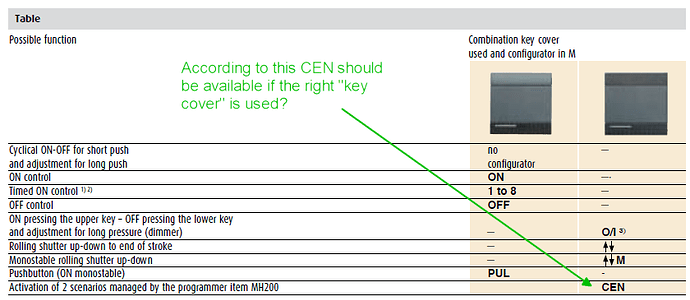

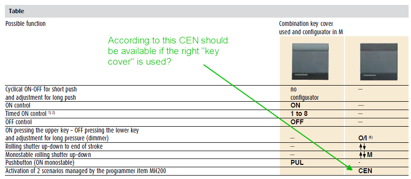

Got a used MH202 to replace our broken F420 and am now trying to link it up with our different controls. So far I could get it to work with the HC/HS/HD4680 scenario control and also with the L4652/2 models with and without ID.
Ironically I cannot get it to work with the L4651/2, the controls we previously used for scenarios with the F420. Those are older models without ID and not the L4651M2. Still, according to the manual it should work, at least if a specific “key cover” is used then CEN should be available for M and enable linking it to the scenario programmer:
Screenshot - 18_12_2022 , 06_37_36

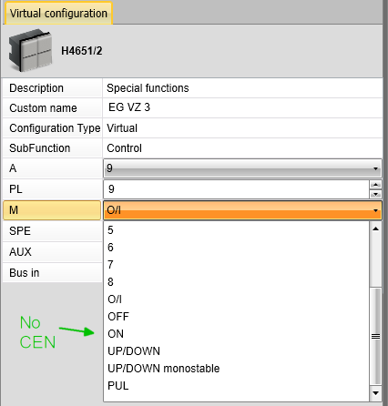

However, in the My Home Suite, I do not get the CEN option for M:
Screenshot - 18_12_2022 , 06_35_48
Does anyone know what is the background of this and why the CEN option is not available for our controls?

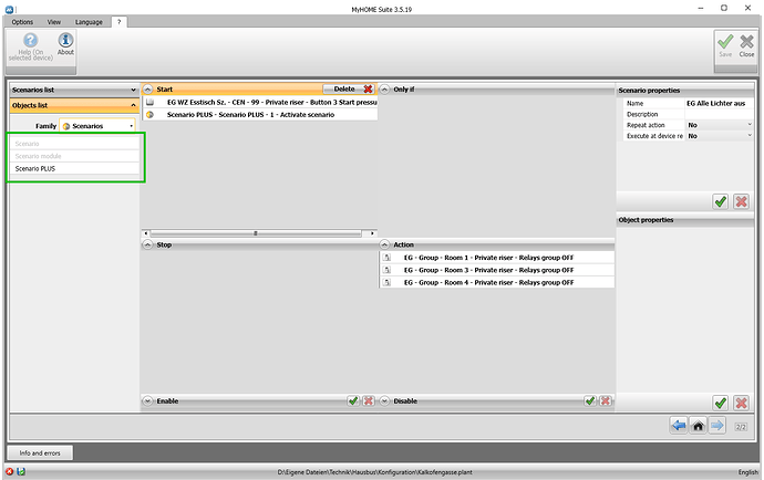

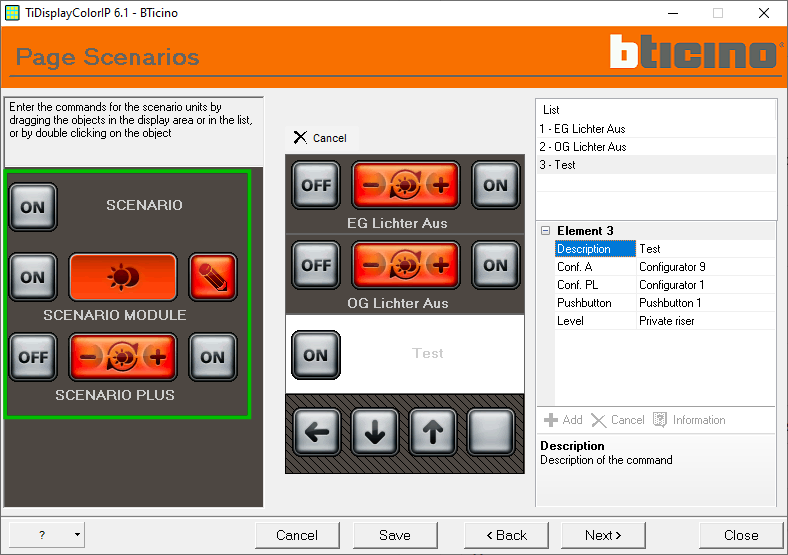

I am back with another question regarding scenarios. I am now trying to link up our 4684 touch screen with the MH202 scenario programmer. I am able to do that using the SCENARIO PLUS command on the touch screen, however that offers more controls than I need (ON/+/-/OFF). I’d prefer to use the SCENARIO command, which only has the ON control:
Screenshot - 19_12_2022 , 13_22_09

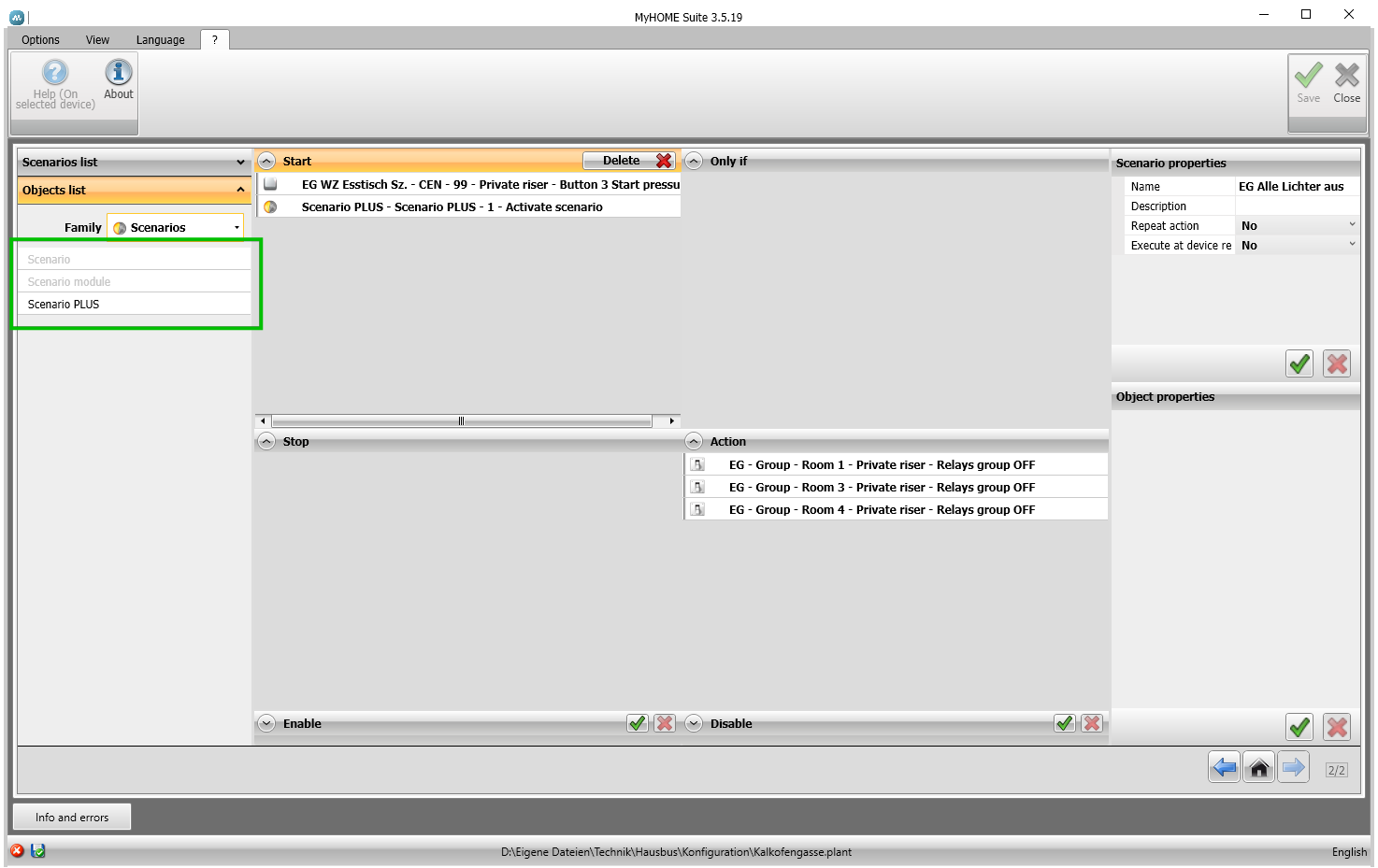

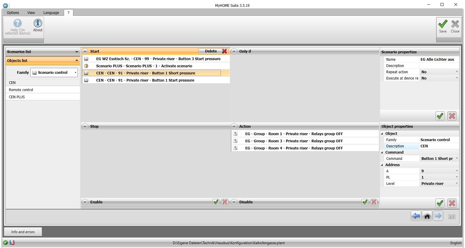

However, I am not able to setup the scenario in the MH202 to catch the SCENARIO command. While under Scenarios, the MH202 offers the same options as the touch screen, only the SCENARIO PLUS can be choosen as start condition:
Screenshot - 20_12_2022 , 07_04_12

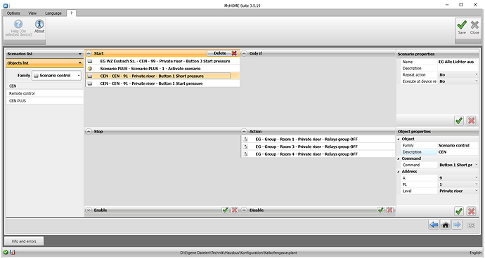

So I don’t know now how I can catch the SCENARIO command triggered by the touch screen in the MH202. What I have also tried is to see if the touch screen sends out a CEN command, but that does not seem to be the case. At least when I setup the scenario in the MH202 to listen to CEN commands, it works with our 4680 scenario control, but not with the touch screen sending the SCENARIO command.
Screenshot - 19_12_2022 , 13_43_51
So, my question is: does anyone have an idea how I can trigger a scenario in the MH202 using the SCENARIO command of the 4684 touch screen? :grinning:

I have tried all the four CEN triggers (start, short, long, release after long), none of them works. I also tried the Remote Control trigger, does not work either. CEN PLUS uses a different addressing model, instead of A/PL there is a CEN PLUS address, but I don’t see anything like that in the touch screen configuration, so I don’t think the touch screen uses CEN PLUS.
Is there any way I can “sniff” the command sent out by the touch screen to better understand what is happening?
