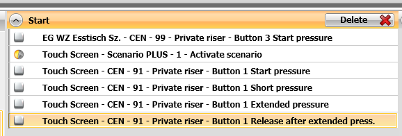

Thanks, the clients works and I can see the messages.

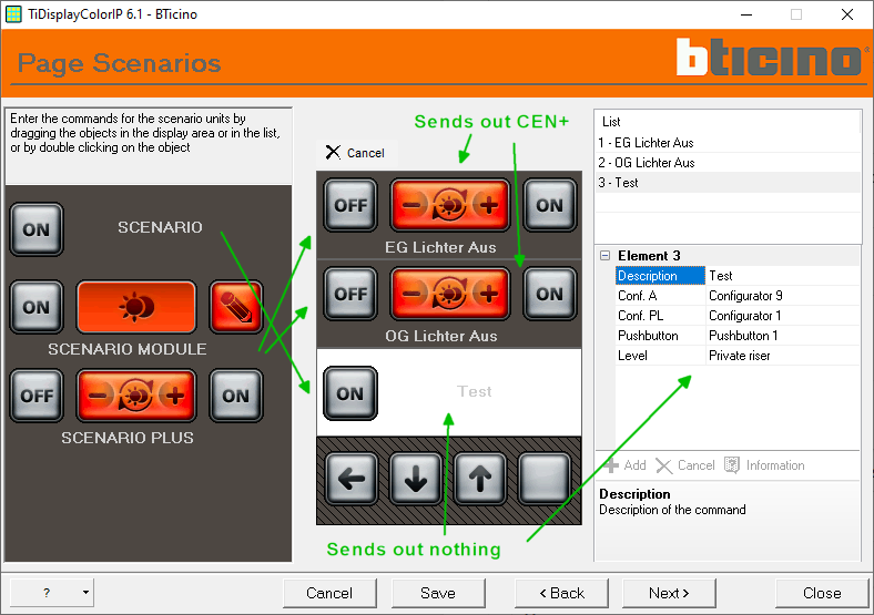

Or, in case of my problem cannot see them. It seems my touch screen is not sending out any message at all when using the SCENARIO command.
If I setup the SCENARIO PLUS command in the touch screen, I can see a CEN+ message on the bus (2511#011##). If I push a button on the 4680 scenario control I can see a CEN message on the bus (150199##). But if I use the SCENARIO command in the touch screen, there is no message at all on the bus.
What could be wrong with my touch screen configuration for the touch screen to not send out anything at all?
Yes, I can see now that when using the SCENARIO PLUS command on the touch screen, it sends out a CEN+ message. I initially thought that the SCENARIO PLUS is something different again, because there is also a separate trigger called for that in the MH202, independent of the CEN+ trigger. Also the SCENARIO PLUS command in the touch screen has these additional controls, which are available in the MH202 as well.
Anyway, the SCENARIO PLUS is working and I can also use it to trigger the MH202, but I would like to use the simpler SCENARIO control because I only need the ON command, not the four ON/+/-/OFF commands.

Hmmm, yes, mine does not do that. In the TiDisplayColorIP software I can just assign the scenario address and all four controls will stay, even if they are not used.
Still, as workaround, I can use the SCENARIO PLUS and ignore the unused buttons. But I am nerd enough to really want to figure out why the normal SCENARIO with the one button is not working as it should. :wink:

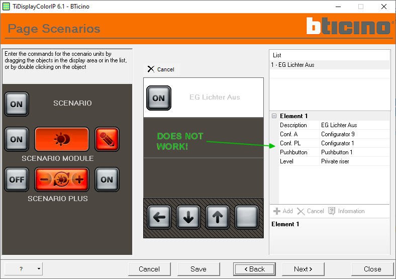

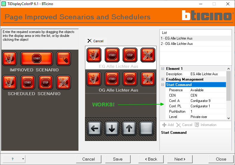

I am one step further now. Tried the “Improved Scenarios and Schedulers” page on the touch screen. When I setup a SCHEDULED SCENARIO there and configure it to send a CEN message as Start Command, then the touch screen sends out a correct CEN message, I can see it in the OWN client and it is picked up by the MH202 and triggers the scenario with the start pressure trigger.
But still, when I setup a SCENARIO on the Scenarios page on the touch screen, nothing gets send out and I still would like to figure out why. Maybe it is simply a bug in the touch screen.
Here are the two configurations, they look exactly the same, but one works and the other does not:

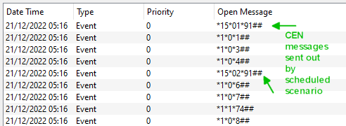

And here are the CEN messages sent out by the SCHEDULED SCENARIO. The subsequent messages are then the ones generated by the MH202 scenario.

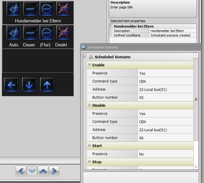

long time ago when i changed the settings of my tochscreens, now opened and checked for you.

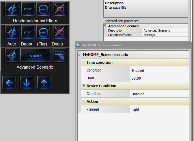

on my touchscreens i have two opinions: “advanced scenario” and “scheduled scenario”. i never used the “advanced scenario” because this does not fit to my needs.
in “scheduled scenario” my settings look like
in “advanced scenario” i could set a time condition and this i never tried:
Thanks a lot, Stefan! The “Scheduled Scenario” is what I am using now as well, it seems to work fine and only displays those buttons on the touch screen that I enable. Actually no idea why it is called “Scheduled Scenario” because there does not seem to be a schedule involved.
What you are seeing as “Advanced Scenario” seems to be the same thing that is called “Improved Scenario” in the TiDisplayColorIP software that I have to use for my older 4684 screen. Both of them are under the “Improved Scenarios and Schedulers” page.
In TiDisplayColorIP I also still have a page called “Scenarios”, with “Scenario”, “Scenario Module” and “Scenario Plus” as options, with “Scenario” being the one that does not work. “Scenario Plus” is an interesting CEN±based option because it involves dimming control that can be caught as triggers in the MH202, while the “Scenario Module” is intended to be used with the F420.
