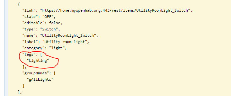

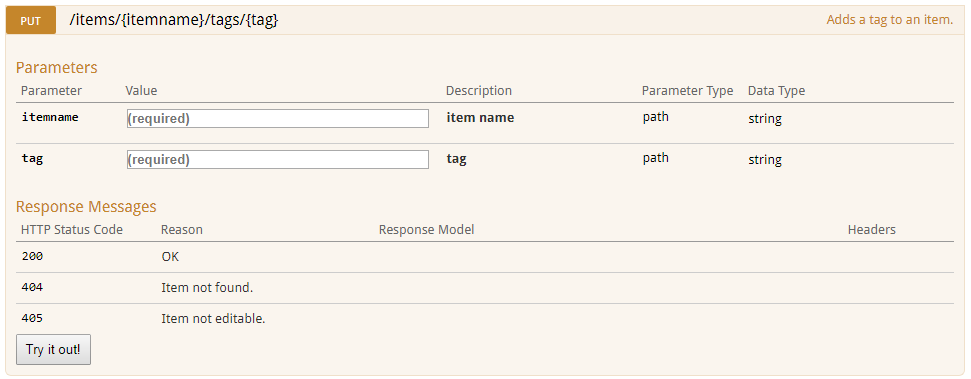

I have Amazon Alexa and so cannot help with Home either. You can check, add and delete the tags using REST API or as Stefan says create the entries manually. REST API is the easier route and accessed from the openhab dashboard. I have not tried but I don’t think its an easy task to safely edit the json database directly.. use REST API.
eg below is part of the API response to ‘get items’ and you can see the tag. Editable =false because this item was created using the items file but PaperUI created items will be editable.
to add a tag use PUT and enter the item name and tag
