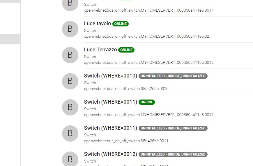

Hi Massi
two days ago, after a power supply defeat, my BUS Gateway (MyHomeServer1) goes offline, but only in OpenWebNet bindings. It works fine with app.
So I have disinstalled and reinstalled OpenWebNet bindings as indicated in the instruction
After reinstallation, the bindings discovered the bus gateway correctly but with another name.
So now I have all the new things work correctly and all the old things stopped UNINITIALIZED - BRIDGE UNINITIALIZED
How can I remove the old things?
Thanks a lot
you have two options:
  1. To delete old ones and DO NOT touch the new ones you can only do them one by one by hand.
  2. CAUTION
    These commands delete ALL, OLD AND NEW, like starting from scratch.
    Through Console Karaf you give the command
smarthome:inbox clear
smarthome:things clear
smarthome:links clear
  1. Start from scratch with Discovery
Make sure you are using version 2.5.0-M2-1
Yes, you can freely delete the old ones. If you have items generated automatically by PaperUI you are ready to go. If instead you are using .items file to configure items, you should used new channel names for them referencing the new gateway name (it’s a simple find all/change for the brdige name).
Bye
Massi
Hi Michele
I’ve tried to delete the old ones one by one, but they still remain in “removing” state
I think I want to try the second method.. :disappointed_relieved:
you can click to remove them again, they should become removed (they need double click since the orginal bridge thing is not there anymore)
bye
M
Ok, I try this evening
thank you

Hi Massi
it works!
I’ve removed all the old things clicking two times!
Thanks a lot!
Giuseppe
