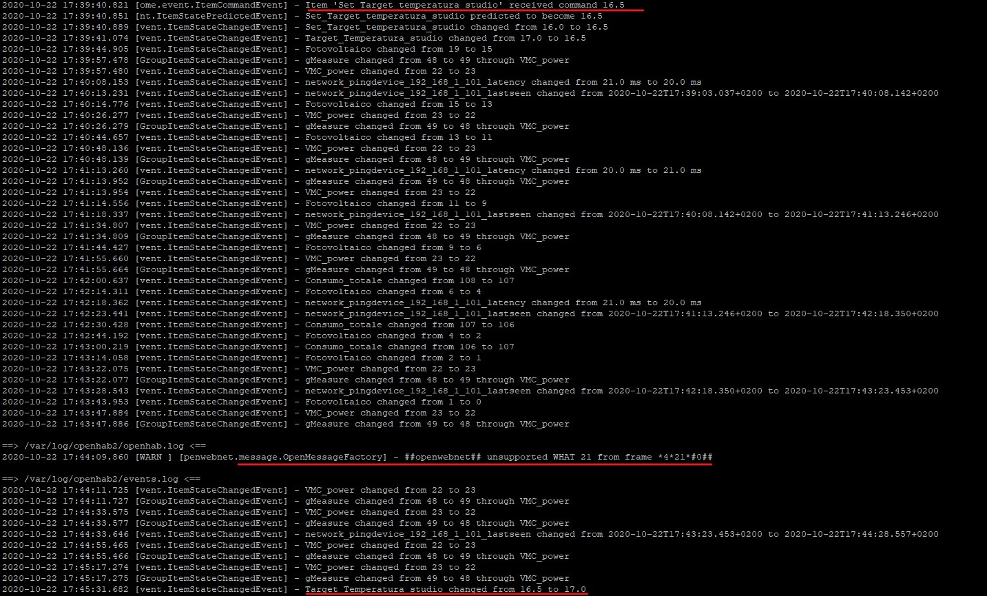

I have configured four thermostats but every time I change the target temperature, after a while, the central station 3550 reset these parameters with his settings.
Why? Anyone else with this problem?
long time ago that i tried that, so not sure but i know there was a bug in the heating, i think it was with the maual mode and adjust target temp.
but because this binding will expire soon and replaced by a new one this bug will not be eliminated so i think you have to wait for the new openwebnet binding.
I think thermostats are in read-only mode.. I have to read the binding definition

Maybe I have a partial solution. If I create a rule that every time the “targetTemperature” change without his relative item, the system set the parameter with the old value.
mmmm, It’s a partial solution really…my thermostats central is scheduled every 15 minutes and I think the thermostats sends the value every time: in this case your rule runs every 15 minutes ?!?

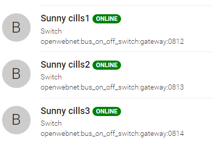

I have a problem that maybe someone knows the answer to or can test for me.
To get from running MH202 scenarios to openHAB I sometimes use what I call virtual items. These switches that are placed in a scenario and send an Off or On commands. The actuators do not exist, so its cheap to do, and I call these virtual switches. They just send a command onto the BUS and the openwebnet binding sees andcan then trigger a rule.
eg
item
Switch SunnyCills1_VirtualSwitch "Virtual switch: Sunny cills 1" <blinds> {channel="openwebnet:bus_on_off_switch:gateway:0812:switch"}
Thing
//Virtual switches
Thing bus_on_off_switch 0812 "Sunny cills1" @"Test" [ where="0812" ]
rule that is triggered
rule 'Moving to sunny cills1'
    Item SunnyCills1_VirtualSwitch changed to ON
    logInfo("Blinds",'Sunny cills1')
    AlexaStatusAnnouncement.postUpdate('Moving blinds to sunny cills position one')
    BlindPositionMode.postUpdate('Sunny cills1')
    BlindPositionModeChanged_Timestamp.postUpdate(new DateTimeType)
    json = '{
        "time":' + Long::toString(now.millis) + ',
        "tags":["BlindControl"],
        "text":"Sunny cills1"
    var output = sendHttpPostRequest(url, "application/json", json)
    logInfo("Blinds",  "Annotation output:  " + output)
This works and I have others using address 8.1 through to 8.15 and 9.1 through to 9.15 which are mixture of real actuators and non existent vritual actuators.
If I use any other adress outside the above range then the virtual switch trick doesn’t work.
One clue is that if I use myHomeSuite to send a command I get a success for my working virtual switches and a fail for the non working ones.
The virtual switch idea works great but I have now run out of working addresses.
Has anyone got any clues as to what is going on or what tests i could run to check this further and use other addresses beyon 8.xx to 9.xx.
I suppose I could try sending virtual CEN or CENP commands instead.

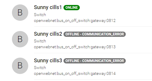

I do a create a Thing. Its online for those virtutal devices that work and offline for those that don’t. I’m guessing that the binding responds to BUS commands and hence they succeed when testing for myHomeSuite but only for address A between 8 and 9. Something odd with the binding for 8-9 or maybe the way I set it up?
I was testing the addresses with Sunny cills 1 and then it dissapeared from Things config. Restarted OH and it reappeared They shows as offline in Things config until the switch is activated either from OH or test send from myHome Suite
Adresses 8.12, 8.13, 8.14 do not physically exist!
