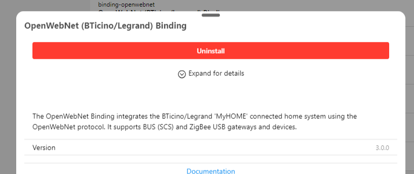

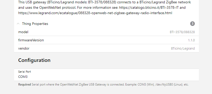

I confirm I use 3.0.0 binding, see screenshot. Firmware version of my bticino USB dongle is 1.1.0.
BindingVersion USB_firware_version
