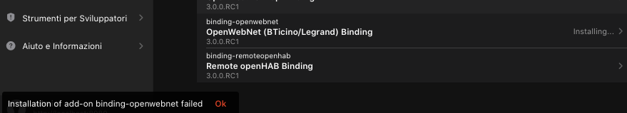

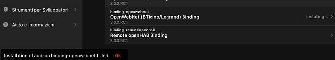

Hi all I’m trying to migrate to OH3. I installed today the last version but the binding is not installing.
With the previous the released functions was ok.
Maybe I’m making something wrong??
thank you for your suggestions
you mean with 3.0.0.M5 the binding installed correctly?
Anything in the logs?
RC2 now is working! thank you!
