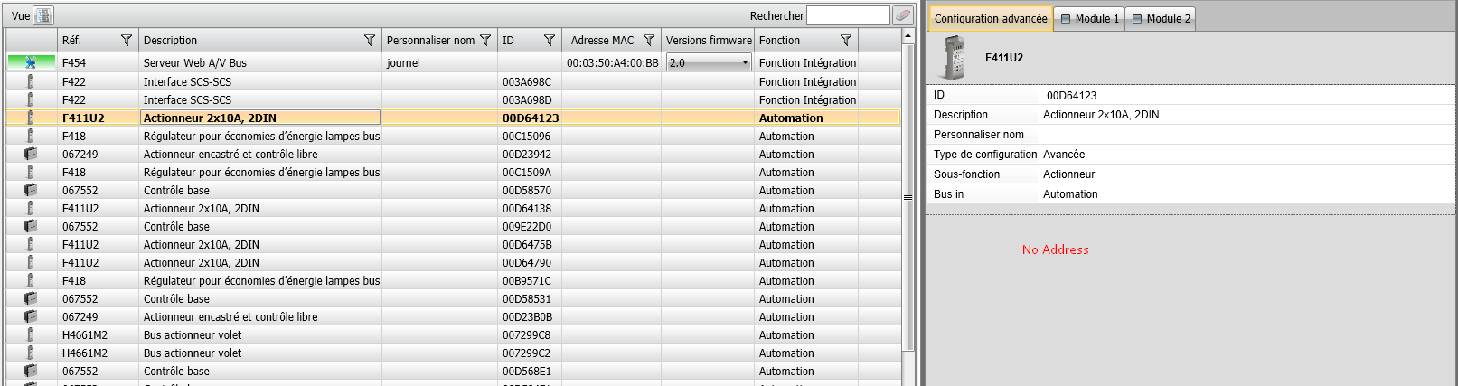

I see you have the same GUI as me. How do you find the adress of the device ?
I am not able to find this in the myHomeSuite software !?
How to get thescreen or the address of the devices please ?

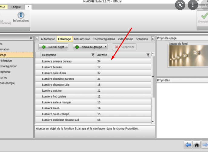

In my home suite you can run a scan. If the physical configurators have been used then check the back of the device to find the address
Unscrewing 72 devices from the wall to find the adress will be not cool :frowning:
Is it not possible to have that window in the software ?
ps: i did indeed run a scan to retrieve the existing configuration

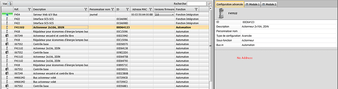

I dont follow. Is scan is working? The scan tab is show before you open the project/config for the S10. You are showing the open S10 configuration.
To get the addresses run a scan, Drag the devices over into the plant area and the save it as a new plant. I copy these into excel to make it eaasier to find things later and add them to the projects S10, Mh202 etc I save separate plants just for S10 and MH202 to keep the file size down.

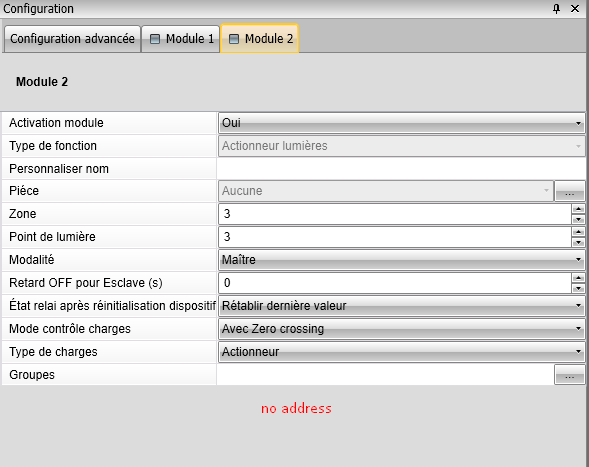

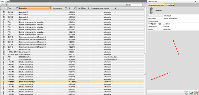

I wanted to send you a pm with my *.plant file.
I did bus scan and import devices.
All i got is this screen but devices address not showing :frowning:

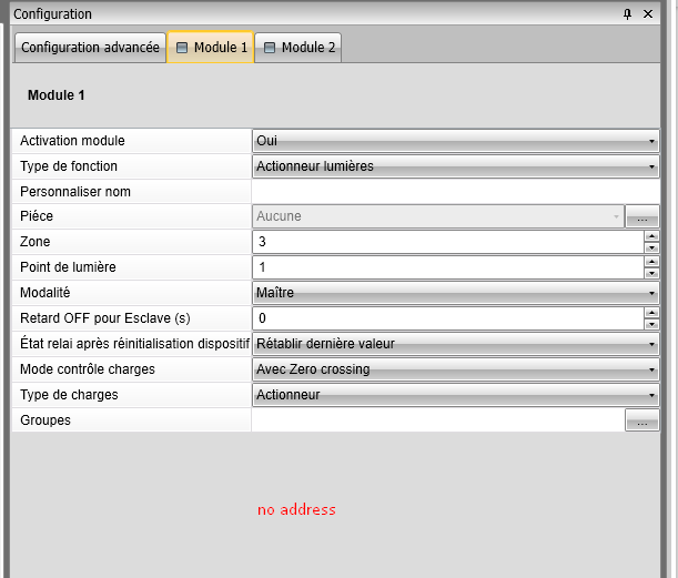

To see the device address you need to click on the module tabs. Each device can be more than one module.. Top right panel
As you can see there is no address also in these panels :sob:
yes it is! as @m4rk suggested eg in your last screenshot (module2) you see “zone” = 3 and “point de lumiere” = 3 → so this is address 33, the screenshot before (module1) is address 31.
this is the number you use in the binding things at “where”

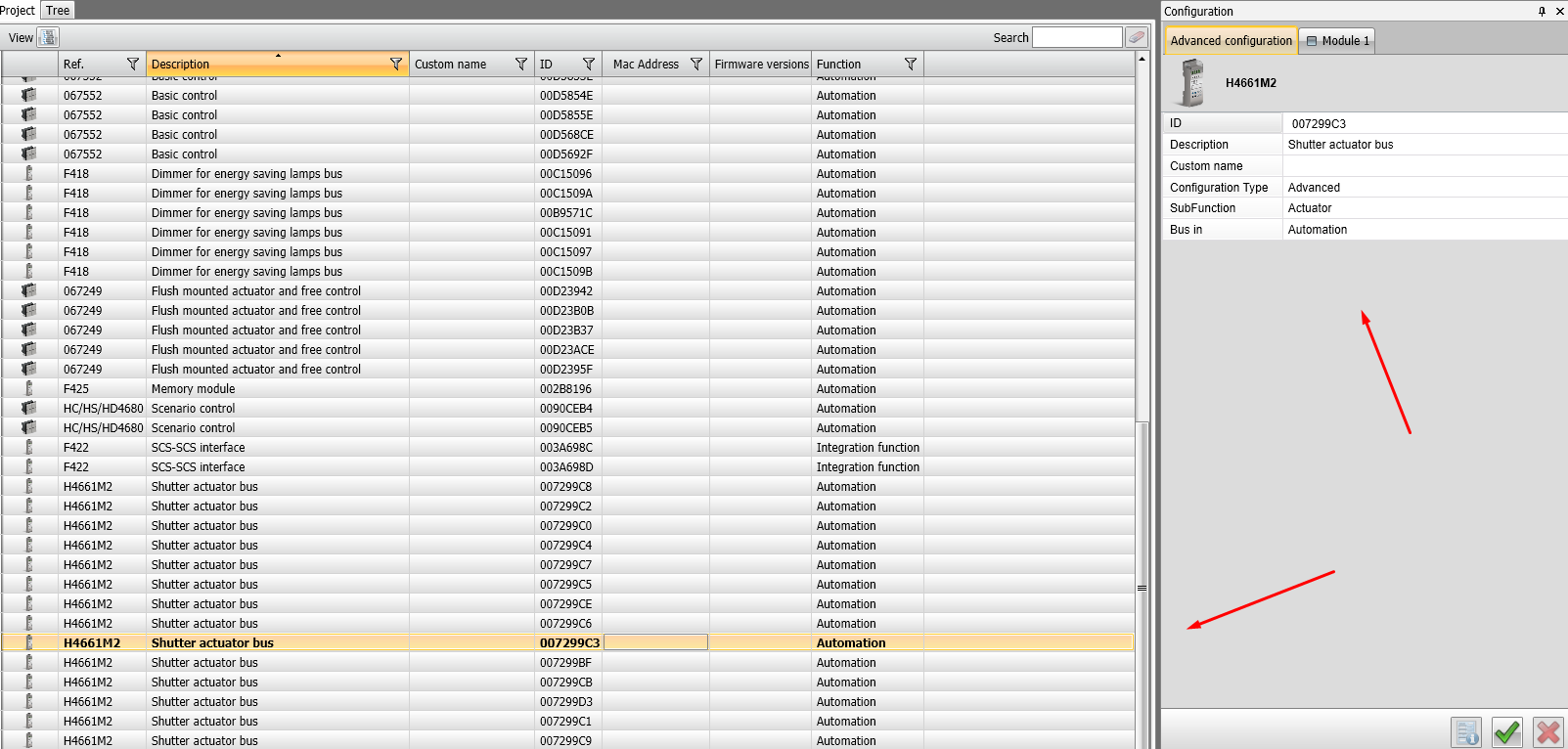

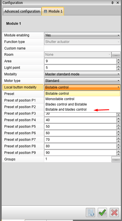

Hi again,
I managed to control a light so i am quite happy. But i didnot manage to control a roller shutter/cover.
I have 2 questions please:
1/ Shouldn t it be set in local button modality in bistable and blades control ?
2/ Seeing this you confirm, the switch for shutter is not set with jumpers ? Or if it is set with jumpers, you confirm it does not exclude from making it work like i did for a light ? Otherwise can i erase jumpers to assign virtually via MyHomeSuite ?
Hope i am clear, i just want to know if i am doing things correctly…
sorry i dont quite understand what you want. i dont use the h4661m2 actor, i use a normal f41174 even for my shutters.
but in generally i would configure ALL components via myhomesuite (as far as poosible, eg some alarm-components are not able to be configured virtually). so if the actor has an id i would remove the configurators, remove power short to reload, and then configure via myhomesuite
