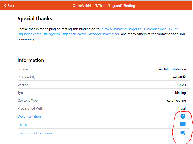

What’s the current status of CEN, CENplus integration, temperature proble and how to test?.. Uninstallthe official binding and download jar file? … from where?
