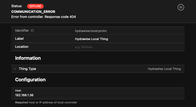

Hi Dan, thanks for the binding, brilliant, a couple of questions if you can assist with Hydrawise over local thing giving response code 404.
Pro HC firmware 4.31, installed binding shipped with OpenHAB 3.2.0M5
  • Is this the correct one for local connection or the jar above pre-release 3.x is still the preferred atm?
  • How do I get access to the local username and password? I might be missing something obvious here … :grimacing:
Thanks!
The username and password will be in the settings menu on the unit itself, not through their app. Unfortunately they removed local access from later hardware versions some time ago, so its likely you may not have local access as an option, for example my firmware is 1.89 which is from around 2017 , i think it may have been removed in v2 or v3.
Thanks. Yep, looks like I don’t have that option.
