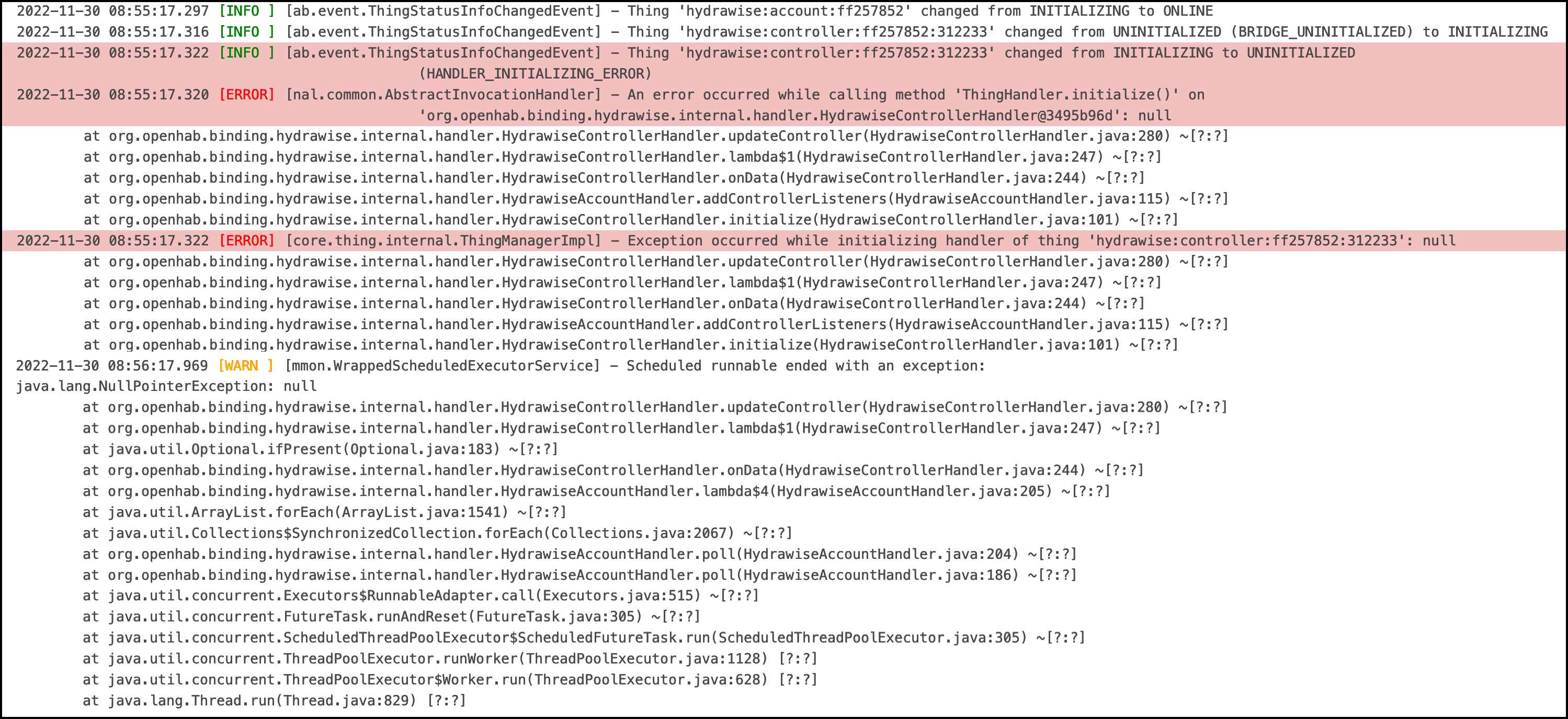

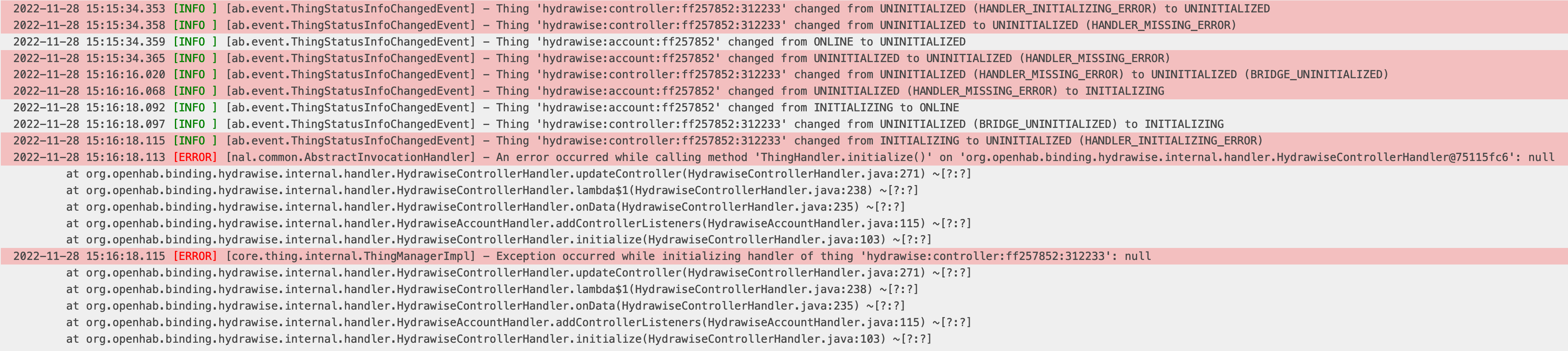

Hi @digitaldan,
same problem for me.
The binding which comes with OH3.3:
I tried the binding org.openhab.binding.hydrawise-3.4.0-SNAPSHOT.jar, same error:
I was able to remove the controller, scan again - controller was found but again âerror handlerâ.
Currently it is not âsprinklerâ time - but spring/sommer will come soon again ![]()
best, Kai
Hi, can you report what version of the binding openHAB thinks is loaded? So from the OH console/cli issue the command:
bundle:list -s |grep org.openhab.binding.hydrawise
The result would look something like:
271 â Active â 80 â 3.4.0.202211090343 â org.openhab.binding.hydrawise
291 â Active â 80 â 3.4.0.202207181728 â org.openhab.binding.hydrawise
Thanks, i think there were additional changes made after i posted that jar, can you try using one from the 3.4 nightly build? Those can always be found at:
https://ci.openhab.org/job/openHAB-Addons/lastSuccessfulBuild/artifact/bundles/org.openhab.binding.hydrawise/target/
Ok, there is definitely quite a few places i assume data should be there that is throwing this error , and probably in other places to if data is missing. I can fix those in the binding, but in the mean time, can you enable TRACE debugging on the binding and PM me a response message from the Hydrawise API with your zones? It will be a giant blob of JSON data, so hard to miss. Want to make sure there is not a larger API issue.
