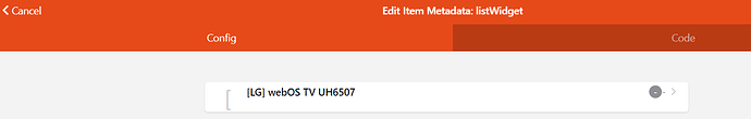

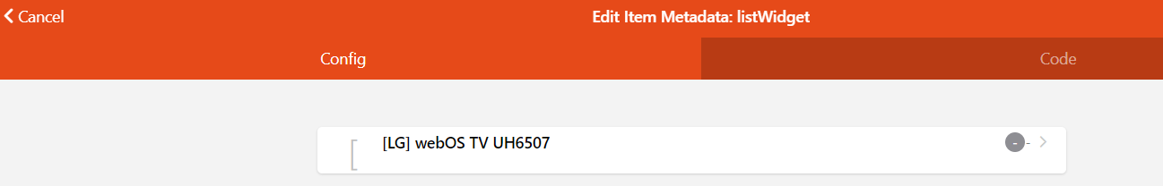

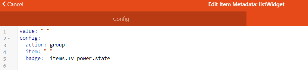

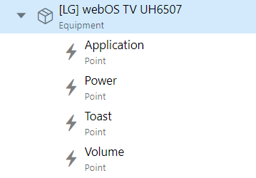

In this example even better would be have tv power status
but I can’t assigne badge. Maybe Im doing this in wrong place
I don’t think it’s possible to change anything about the appearance in the Model view.
