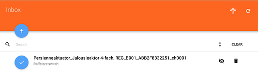

I couldn’t attach my full list of units in free@home with Type of device, as I’m a new user, so I provide the link to XLS file:
I got detected automatically only “Sensor/switch actuator” that comes with _chXXXX, the rest are Dummies, and in the bottom of the list, there are Sensors that were not detected even as Dummy.
Thank you in advance for helping out with the solution!
I would need the input as seen from PaperUI inbox, as the device serials are not used to define device type, rather the device type code. As seen from the example below, I have a Persienneaktuator which is automatically discovered by the binding. Here it is the type code “B001” which the binding use to define the device as “Raffstore switch”.
Similar, for a regular switch, the binding currently discovers switch types which have type codes “100C” and “900C”.
So I would need the different type codes from PaperUI inbox, and also what type of device the different type code equals to, in order to update the binding discovery service.
@kjoglums
I updated the table with type codes.
Please see here:
Thank you in advance!
Although uncertain of what channels your devices actually operate under, I have tried to implement your device types into existing device types / discovery service (i.e. using channels as used by existing/known device types).

@kjoglums
Thank you so much!
All things added successfully.
I don’t understand why state of switches (ON/OFF) is not saved.
I used Home Assistant as alternative, it was able to track the state of switches (though I did not manage to make binary sensors to work either…)
