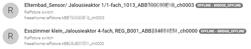

I actually just looked into PaperUI under Configuration - Things and saw, that all these have the status “Offline - Bridge_offline”. Does that help?
Here’s a screenshot:
Apparently both your things and bridge are OFFLINE, so then obviously you are not able to operate your shutters.
Do you have a different bridge as thing in PaperUI which is ONLINE? Then you need to point your OFFLINE things to the ONLINE bridge.
Or, if you do not have any ONLINE bridges, you would need to delete existing bridge, create a new bridge, and point your things to the new bridge.
That’s the weird thing. I only have one bridge and it was online. All raffstores that were offline were still pointing at the correct bridge. I now disabled all of them and enabled them again. they are all online now.
But they are still not operational, as described before. I can operate them from within Paper UI. When I try to operate them from Homekit, I can see the values change in Paper UI, but they are not operating :confused:

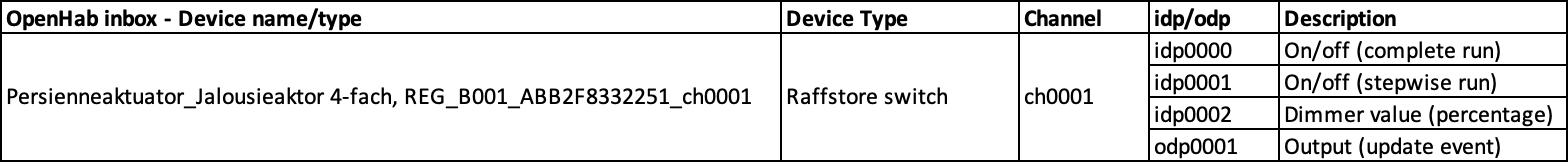

The binding is created based on reverse engineering, and the creators of the binding do not have any wireless devices to use for reference.
The binding use device types (as could be seen from PaperUI inbox) to categorize the devices as OH things (switch, dimmer, screen actuator etc). The binding then enable operation of the devices based on category/standard channels in use.
As per now, there is little information of device type/channels in use for the wireless devices.

What would be preferred:
  1. Install and run F@H binding (latest jar file from further above) and enable “dummy things”. Run discovery, and you should get a list of your devices as dummy things (for your wireless devices not recognised by the binding) with a default name (name then containing the device type ID, which is used in the binding to automatically associate the device with the correct thing handler).
  2. Then sum up your devices (examples of different device types) from OH inbox in a list similar to:
    Skjermbilde 2020-03-27 kl. 08.58.32
From the example above, “B001” is the device ID for “Jalousieaktor 4-fach” for a wired setup, and is thus used by the binding to associate the thing with the Raffstore thing handler which for this specific thing operate under ch0001 using idp0000/idp0001/idp0002/odp0001.
