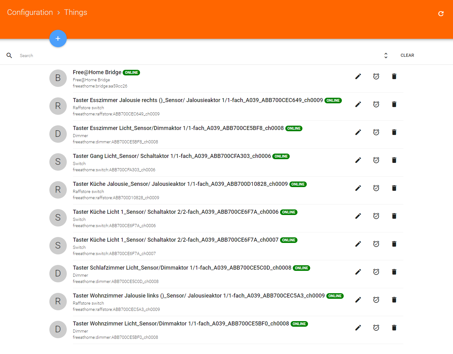

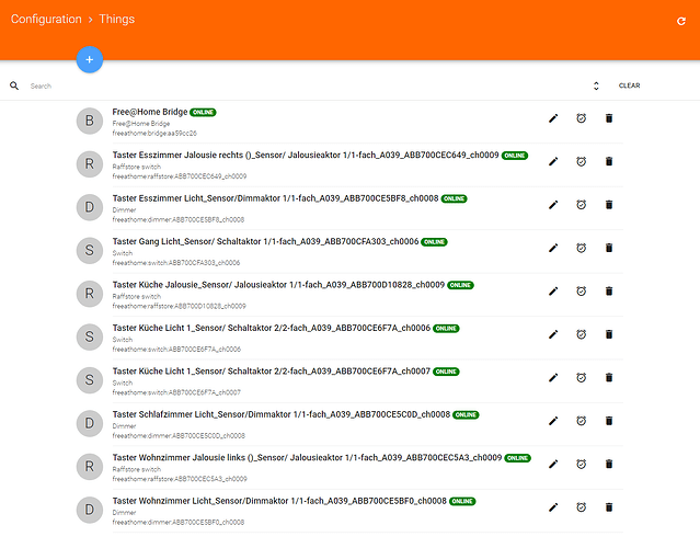

So, I have made an attempt to update the binding to discover and implement the wireless devices as described (using DeviceTypeID A039), setting channels and Thing type based on DeviceTypeName from your list, assuming idp/odp is the same as for wired devices.
F@H 2.5.4-SNAPSHOT
Note
You might end up having devices recognized/listed as different thing types in OH inbox, so you will need to identify the correct one. Will be interesting to hear if your devices now are recognised as correct Thing type, and not dummy thing.
Yes, almost perfect. There is only one problem with the blind actuators. The double actuators (2/2-fach left/right) are recognized as single actuators (1/1-fach) and I can only control one side.
Before the new binding, the double actuator was recognized as 2 single dummy things, see my table in Post 243 “same device”.
Great, and you manage to create operable items for your devices within OH?
The binding is now updated to implement 2/1-fach Jalousieaktor (see you refer to it as 2/2-fach in your previous post, but it appears to be 2/1-fach based on your list as retrieved from PaperUI inbox).
I have replaced the binding in the link in post 246, so you could download the new binding and retry.
Now everything is working flawless. Well done Stian!
Yes, I managed to create working items without any problems!

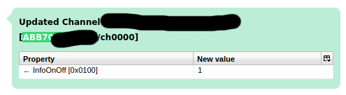

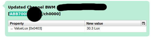

Well, it’s hard to say as you are referring to the device only as motion detector: Is it with or without relay? Based on the ID 1008, I would assume it is without relay (based on similarity to 9008 which is already included in the binding).
So, to get ON/OFF response from your device in OH, I have implemented “1008” as a motion detector (without relay):
F@H 2.5.4-SNAPSHOT
The lux value for motion detectors are not implemented at all in the binding from before, so this would require more extensive work for the binding (i.e. idp/odp, channel definitions/configurations etc).
The same goes for “Zeitprogramme” and “Aktionen” which basically are just some kind of mirror for your “Time programs” and “Actions” as you have set them up in your SysAp. Meaning, your SysAp dumps them as devices within F@H, but really uncertain what information actually could be retrieved from these “devices”, and what there would be to gain on getting them implemented in OH (you regardless get the response of devices which are involved in program/action in OH). As an alternative, you could set up rules in OH to achieve the same as time programs/actions in F@H SysAp, and thus just delete your existing F@H time programs/actions (if your goal is to have OH control only).
Thanks for the implementation.
I could add the motion detectors as thinks. But I can not see any changes in the events.log if the motion is detected. I do not see any error log. In the sysap “free@home Monitor” the changes are reported.
Do you have any idea how to improve debugging?
Your device “1008” is recognised similar as “9008” which also is a motion detector (without relay), a device which already is implemented in the binding (set up as SWITCH, meaning it will report ON/OFF status based on motion).
The “9008” device operate under channel ch0000, and idp0000/odp0000. I have the “9008” device, and for me I get ON/OFF updates in OpenHab when motion starts/stops. No other updates.
As I do not have the “1008” device, I am unable to troubleshoot any further. Not sure if your “1008” device actually operate under the same idp/odp.
