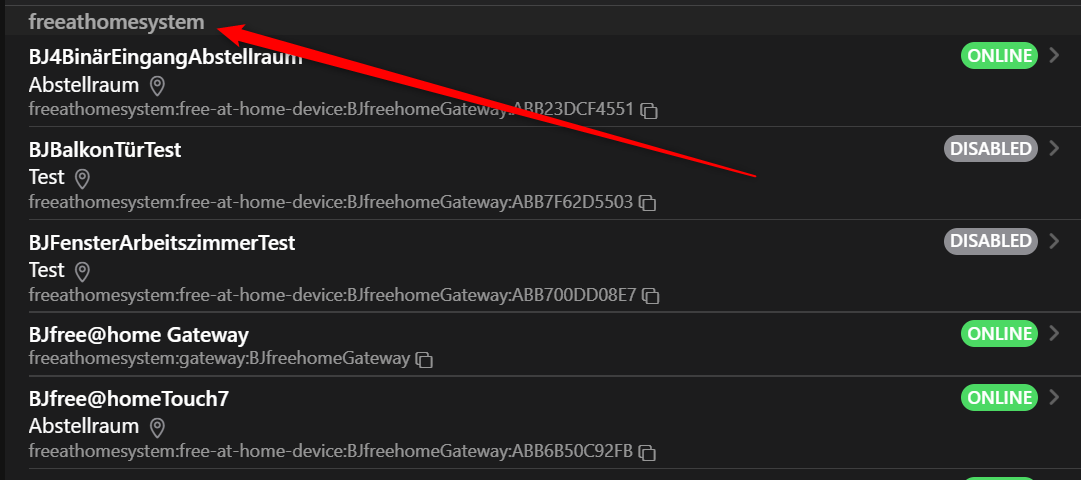

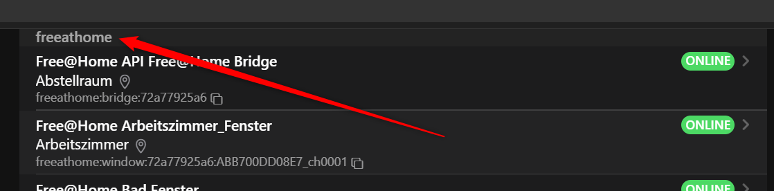

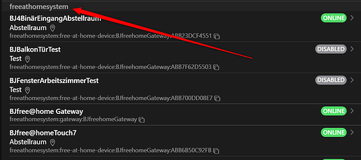

things view:
@kjoglums binding: (Busch-Jaeger Free@Home)
org.openhab.binding.freeathomesystem-4.0.0-SNAPSHOT.jar
things view:

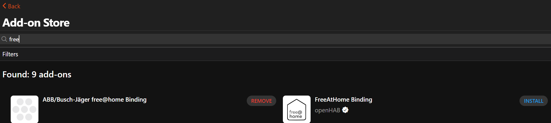

here my add-on store:
I assume the left one is the @UhA binding in the add-on folder. And the right one, which is currently not installed, is the new binding that is integrated into OpenHab. The new “FreeAtHome Binding” is the successor of the @UhA binding, right?
So I can confirm that my current configuration is working. But what would happen if I installed the FreeAtHome Binding through the Add-On Store? Is it possible to run all three bindings at the same time? My ultimate goal would be to use only the new FreeAtHome Binding, but the migration would be easier if I used all three at the same time.

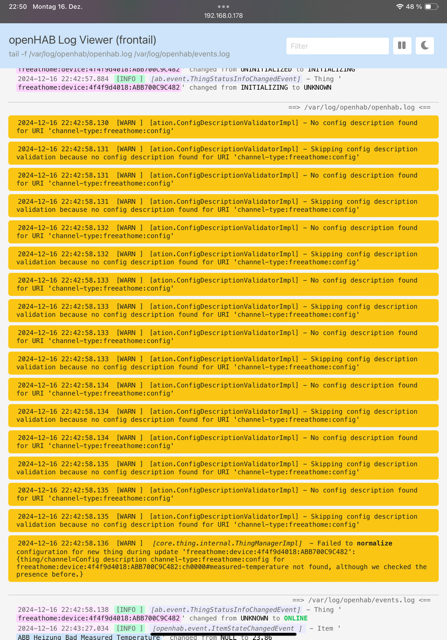

Is there a chance to reactivate this thread ? There a major problems with the new built in binding for openhab now:
Do you have also problems ?
