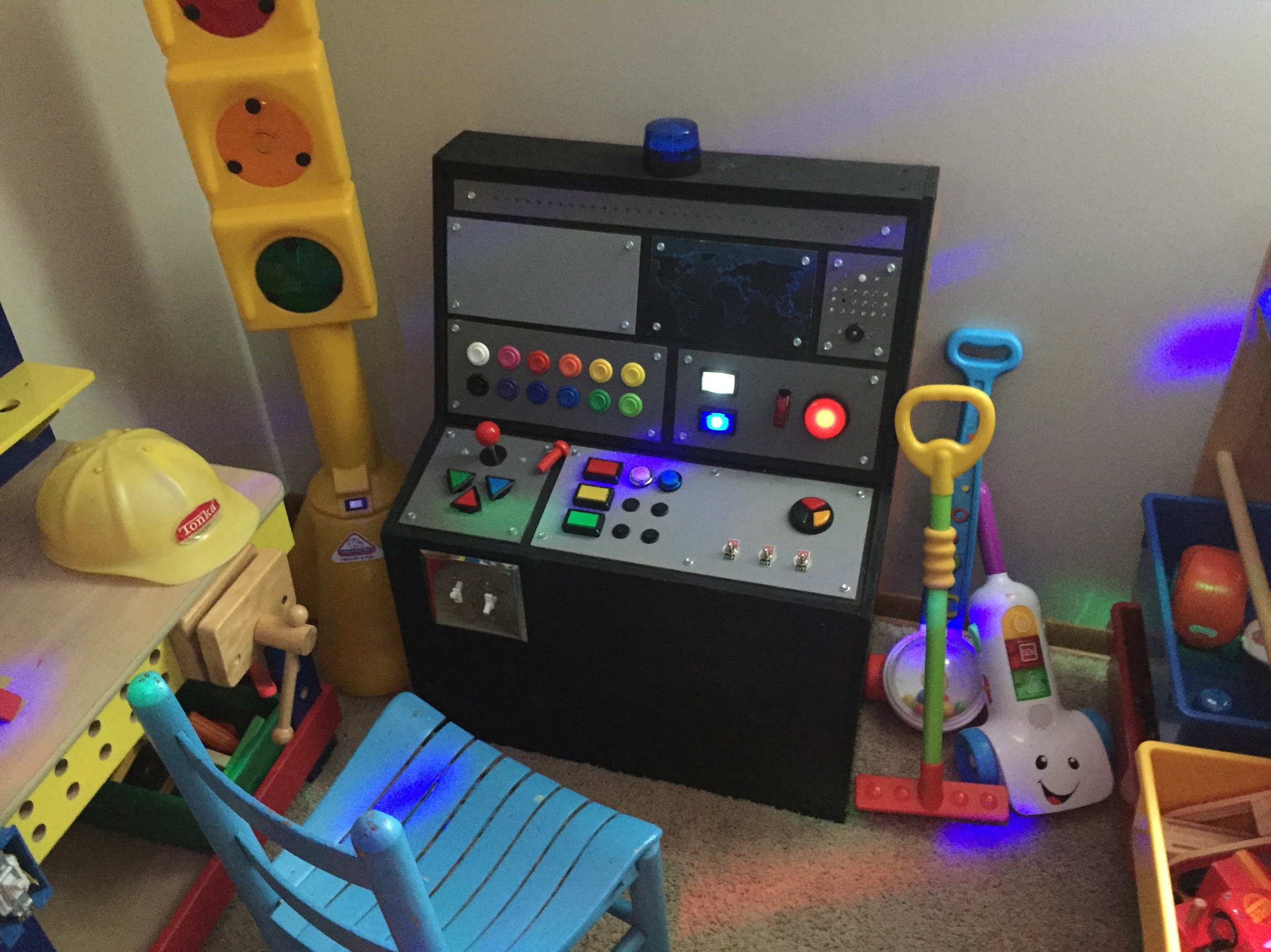

Not sure of your DIY skill level, but another option is Arduino or similar micro controller with connected arcade buttons.
Here’s an over the top example (it’s for the kids and connects to openHAB through MQTT).
