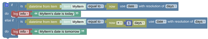

If in a rule, like I said, you don’t need an Item nor the NTP binding. If using Rules DSL now will be this exact moment in time. Blockly has a now block. JS Scripting has time.toZDT(). In all the cases to compare to get a date time for tomorrow you just add a day (e.g. now.plusDays(1)).
Let’s say you are using Blockly and your iCal Item is MyItem:
Notice, the only Item involved here is the iCal Item.

Then it should be relatively simple for you to translate the above Blockly to the language of your choice. All the reference docs for all of the supported languages cover how to add/subtract time to now.
