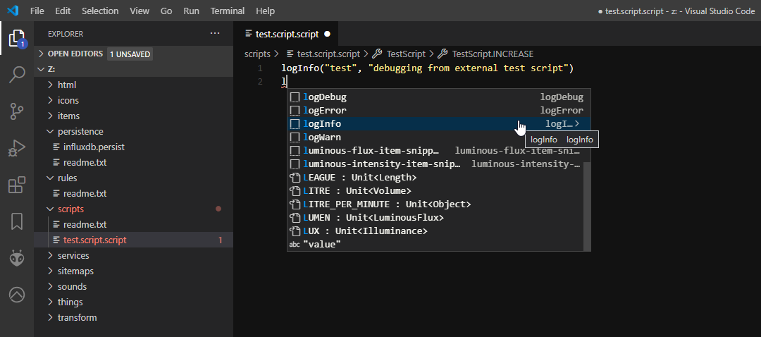

I’ve setup VS Code with the openHAB extension, linked it to my openHAB server and have access to the $OPENHAB_CONF/scripts directory. Bearing in mind the workaround for the bug related to calling external scripts (Scripts in OH3) I created a test.script.script file and am able to call it successfully using callScript(‘test.script’). I am currently doing this by defining a GUI-based rule that “executes a given script” and therein I simply have callScript(‘test.script’).

Gotcha. I left out that the main reason I’m using external scripts is a preference for the functionality of the external code editor (structure wireframing, syntax validation, design patterns, code completion, etc.) since I am new to learning the openHAB ecosystem. This is in contrast to expecting extra functionality or code reuse from external scripts.
