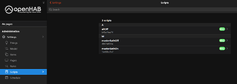

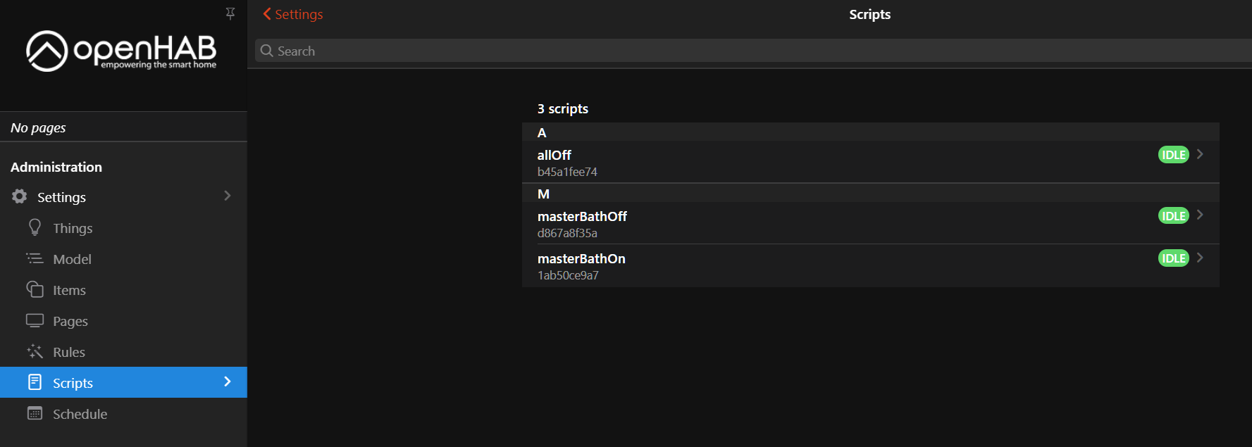

Tried to copy my 3 scripts into the new framework, but unsure how to use them.
Rule did not find them using callScript():
