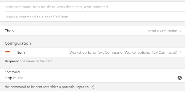

I just use a text command that says Stop Music. It has not failed.
