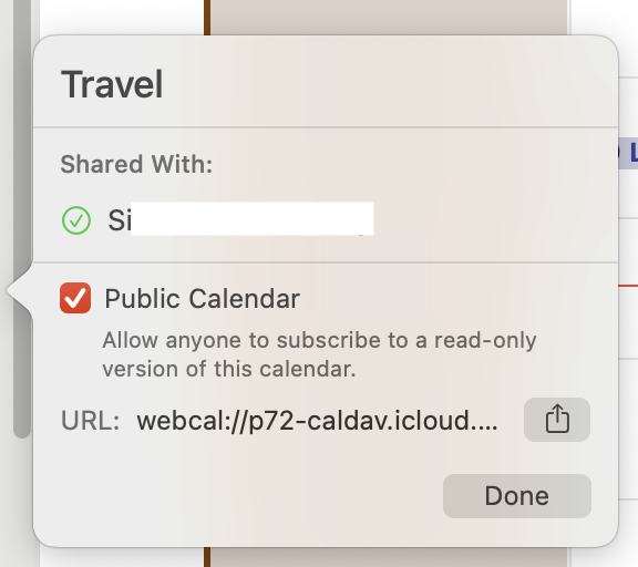

I agree that it would be better if the openhab binding could handle authenticated access, however using the “public calendar” option is compatible with access for specific people. I am using calendars with OpenHAB that simultaneously have user-specific access (for humans) and public sharing (for OH).

That’s the result of both public sharing (read only) and individual sharing (full edit access).

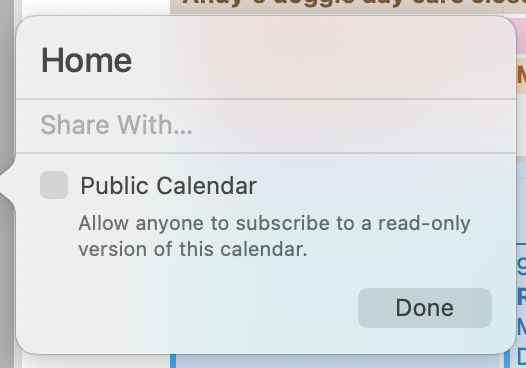

You just need to add the individuals to share with in the middle “Share With…” section and then tick the box for Public Calendar below that.

Ok I have successfully got three calendar bridges online - I thi j the magic combination was this:
  1. Create the bridge and copy and paste the URL from the public link in iCloud
  2. Change the URL to start with https
  3. Go back to your calendar and tick private AS WELL and then share with a family member
  • this seemed to make the bridge come online automatically.
For anyone reading along my other question was how do I change a private calendar to a public - what I actually had was a family sharing calendar set up - if you’ve done this you don’t see the private or public tick boxes in iCloud - BUT if you go to the settings on the calendar on your IOS device you see them there as well as the link you need for the bridge
