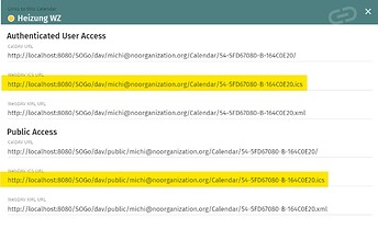

URL in SOGo
Another example is SOGo. Retrieve the URL use the menu and there „Links to this Calendar“ and then copy the WebDAV-ICS-URL (either public or private as you prefer). Using the private URL, the authentication is done by your normal login data.
Selecting the right calendars URL-overview
Choosing the right URLs for icalendar-Binding

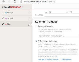

URL in iCloud
iCloud also allows to share a calendar, but only without authentication.
getting a public iCal URL from iCloud
Your calendar solution may gives you an URL beginning with „webcal://“ (like iCloud). In that case, just try to get a result in your browser by replacing „webcal://“ with „https://“ or „http://“ and use the working URL. Comparing to a caldav-URL, most cases the URLs are quite similar e.g. Nextcloud just adds an „?export“ in most cases (not always).

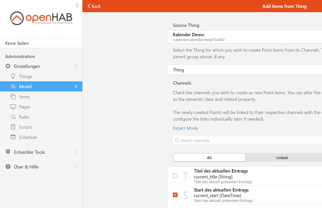

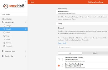

Create items using the Bridges channels (here done with „Create Points from Thing“):
using icalendar bridges things by adding points in the 3.0 UI

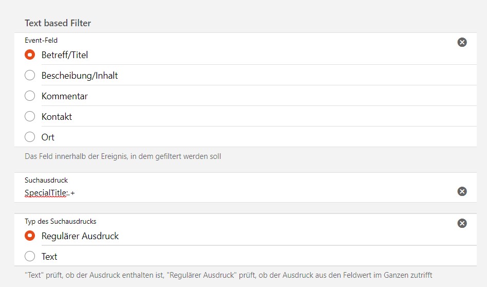

The text filter allows to retrieve events by their contents. The easier mode is to use the simple text filter. If the event contains in the selected field your text, it will be shown. Here you can also use regular expressions. Note that if you use regular expressions, your expression has to match the whole string. Here is an example for specially titled events:
events beginning with "SpecialTitle:" by filtering with a regular expression

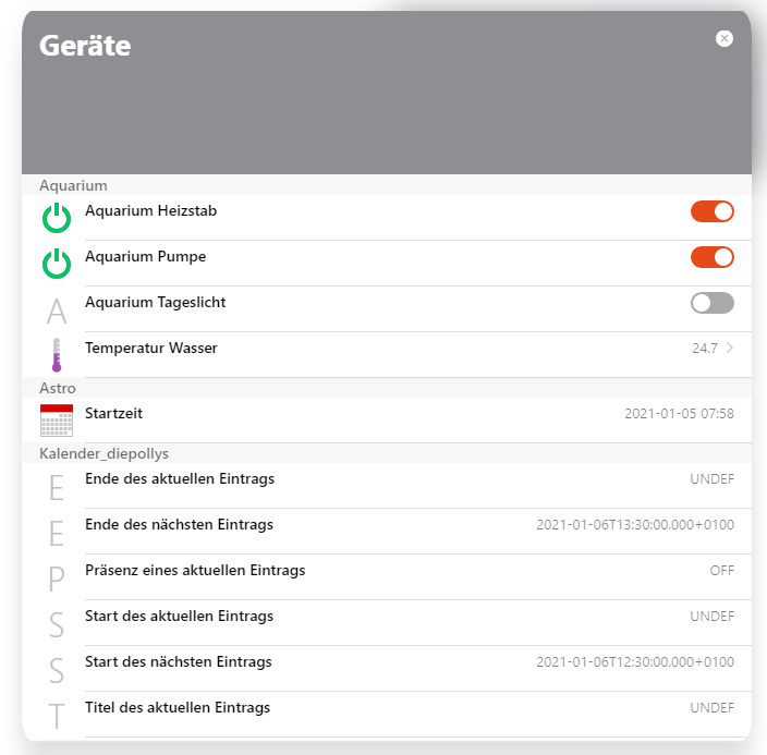

Now I’m able to switch items via command tags out of my main gmail account.

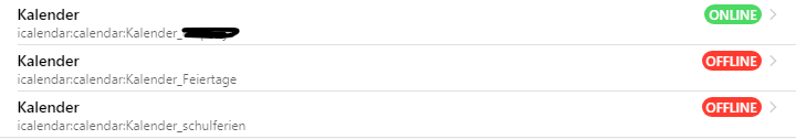

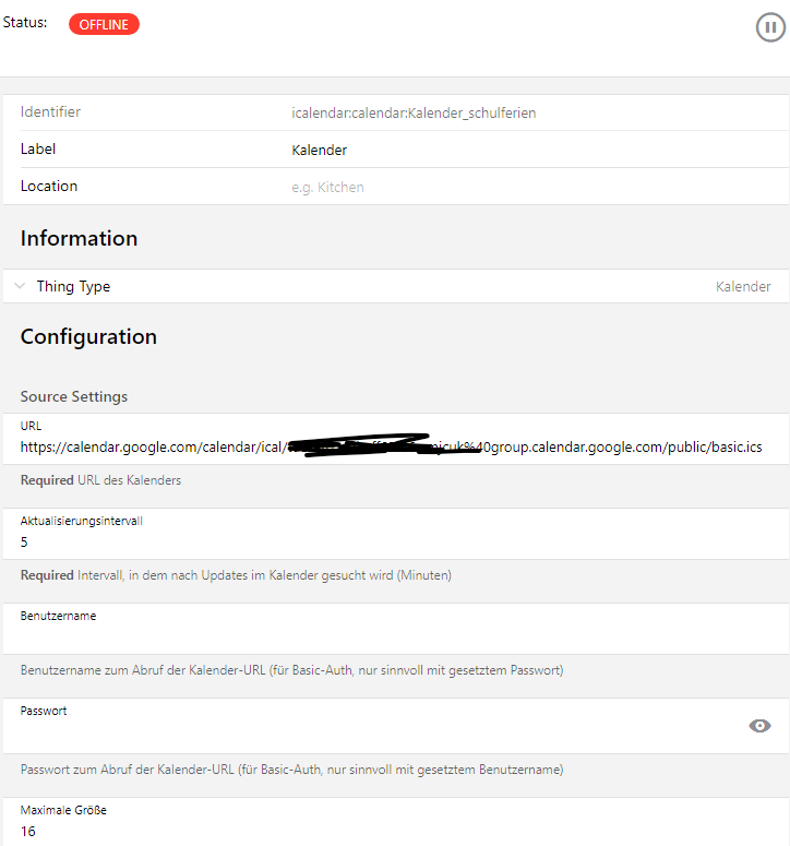

I do have “sub-calendars” for garbage, birthdays and school holidays. unfortunately I`m not able to integrate them into iCalendar binding.
Download of calendar timed out (waited too long for headers)
thats the only message I receive in logs, the Kalender thing itself reports an offline state.
Any idea how to solve this?
thanks

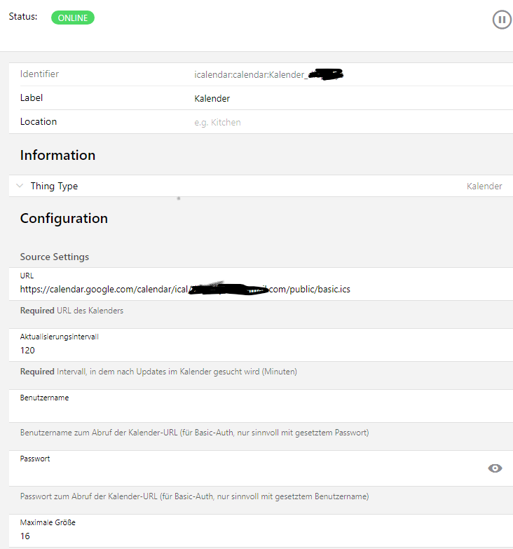

Can you please show us the configuration of the calendar thing. If you look into my tutorial there is a example setup of a calendar thing.
I also use iCal with Google’s calendar, and have a dedicated calendar for school schedules. In the settings click on the other calendar and on the right side scroll to the bottom there is a private iCal URL, I pasted that into the Bridge and created the channels/items.
I tried both the public and private ical URL. I also enabled “share publicity” to test it.
Here a bit general advise (not only for Google Calendar):
First of all, please try to retrieve the calendar using the URL you have in a browser using a different internet connection e.g. via your mobile.
If that not works, please check the URL. Are there any typos or invisible symbols (like spaces etc.) inside?
If it works please check your providers limits. People especially using the Google Calendar had issues with too short intervals. In your case this interval at the broken calendar is set to 5 Minutes, the working has an interval of 120 Minutes. If you are hosting your calendar yourself (so you are not using any public cloud), please check the Server Logs. Please check also the connectivity of your OpenHAB instance.
You message sounds like the server is not able (or unwilling) to respond. This really sounds like a connectivity issue or hit limit. In the latter case i would expect a different message but i don’t know how it’s implemented at google and even great providers may behave strange.
when I call the ical URL in a webbrowser, I get a basic.ics file downloaded. opening this file I can see the calender events. however, I do not find a basic.ics file downloaded to OH, should that file exist somewhere?
I also tried another gmail account, some result.
btw. I use the same calender account in OH2.5 with caldav without any problems. (but caldav does not use ical)
