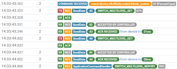

The command is being sent correctly to set the value to 67%, but when queried the device is saying it is at 99%. I’m not sure if there is a calibration routine etc that needs to be run (often there is on shutter controllers) but I would suggest to read through the manual to see what configuration parameters might be available.
