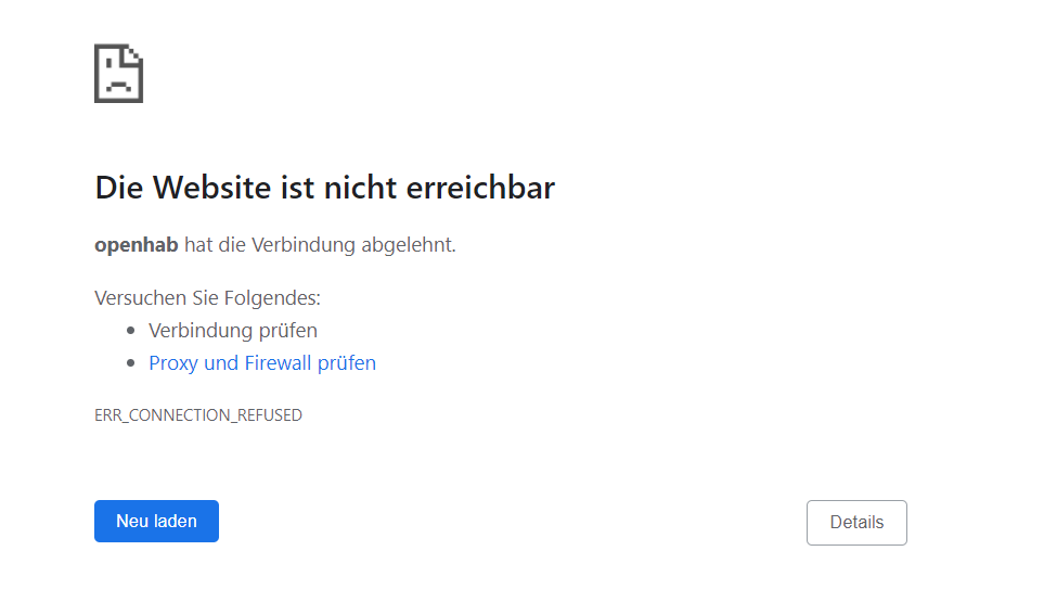

But I can’t access Openhab:8080 to access my sitemaps or the PaperUI.
Any Help here?
As you can see, it doesn’t accept the connection
Thanks in advantage …

It’s a connection refused

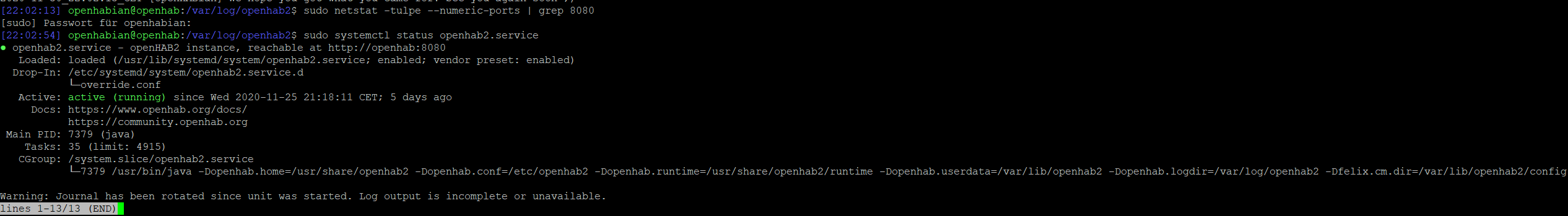

What does
sudo systemctl status openhab2.service
show ?
it shows this:
I’m using a HDD on a usb Port without a SD Card btw
