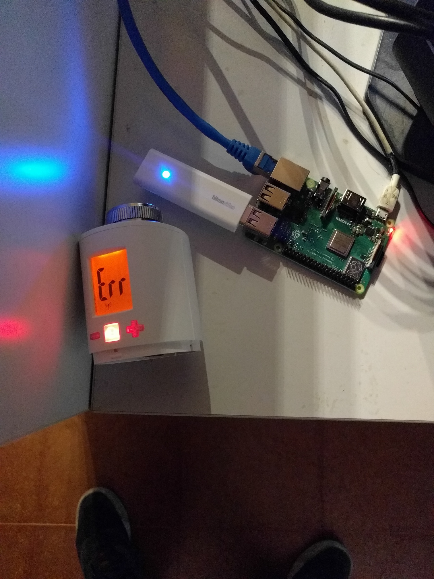

So here is what my attempt with the Raspberry Pi brought up:
I installed a freshly copy of openhabian 2.5.0-1 from openhab.org to microsd, powered the raspberry up (just power cord and network connected). Waited a while for it to come up. After it was up and ready i connected the BitronVideo Coordinator to the USB-Port. It came up as /dev/ttyAMA0. Then i looked up the inbox in paperui, which was empty. Tried to add it manually but it doesn´t came online. Next step i listed the loaded kernel modules where the cp210x was missing. Tried to modprobe it, but rans into an error. Then rebooted the Pi, now the kernel module cp210x was loaded from startup (dunno what was wrong with it in first place) and the Coordinator showed up in inbox, i added it and it came online like on my x86-server before.
Next i tried one Eurotronic to join (with a factory reset this time) and it showed up in inbox, firstly as a unknown device (added it, but didn´t came online) so i deleted it and did an discover again, when it showed up i waited until it changed from unknown device to “Eurotronic SPZB0001” and added it then. This time it is shown as online. But on the Device itself the “Boost”-Button never flashed green (which should indicate that a joining attempt is registered) and after a while it shows “Err” as its not properly initiated. Tried to retrigger this by checking the box “initiate Device” in Thing settings. Changed nothing.
So conclusion:On the raspberry Pi i successful the devices can find each other but is not working correctly at all.

My guess is that the reason behind this failure is that you have a noisy RF environment. The binding sends 2 Join commands - one to the coordinator itself, and one is broadcast. The one to the coordinator is not required for Ember - it was added to solve a problem with the TI dongle.
However, this still means that join is enabled in the coordinator even if other routers in the network will not be able to enable join. It still means that if your joining device is looking for a network, then the coordinator will allow it to join, so it still should be able to join…
However… The failure to send the broadcast is likely a MAC issue (although I can’t prove that from what I can see). This is normally due to high RF levels not allowing the CSMA algorithm to determine a clear point to transmit, and then the command fails. This is currently the only explanation I can provide - I’m not necessarily saying it’s THE reason, but it is ONE possible reason (but there aren’t too many reasons a broadcast won’t be sent and most of the others are ruled out by the fact that the command was accepted and queued in the first place).
Would temporarily moving the thermostat and Zigbee coordinator closer together possibly permit the initial join or would you expect major Zigbee communication issues afterward?
No - this wont help. If I’m right, then the problem is RF noise. This can’t be overcome by moving devices closer since the underlying issue here is CSMA - ie the device will not transmit until it has a clear channel. This can only be fixed by solving the noise issue, or moving to a clear channel.

All my attempts so far the devices were closer than 1 m each other.
So what to do about it? Can´t really believe there is more RF noise around my home than everywhere else in “civilizated” areas. I am livin in a really small town (less 5000 population), of course there is some wlan, dect, gsm etc. around, but I think in bigger citys with more crowded population there would be much more noise.
Should i try to switch channel in Coordinator´s settings? Don´t they use channel hopping anyway?
This is a really bad idea! I strongly suggest to move them further apart as this sort of thing can cause exactly what I describe above. You might also want to get a USB lead and separate the ZigBee dongle from the RPi.
This is an issue I’ve personally seen recently just by having 2 Ember dongles plugged in to the same USB hub. These sort of issues are normally quite local - I already provided some suggestions above.

Is this supposed to work now with 2.5.1 as the pull request was merged?
I can discover the Thermostat with my BitronVideo Stick and it is shown in Paper UI as “ONLINE”, but the thermostat itself is showing “Err” and tries to join again after pressing the “Boost” button. I have reset the Thermostat numerous times, but it makes no difference.
Should this work now and it’s a problem on my side or is this still a work-in-progress and I just need to be patient?
(I’m using the 2.5.1-2 Debian package on a Raspberry Pi 4 with standard Raspbian.)
No - it won’t work still.
