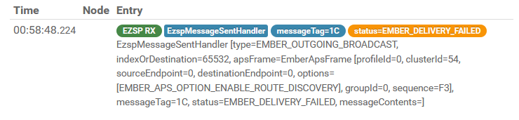

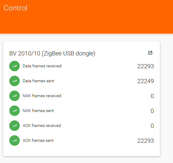

When i look at the stats of the bitron coordinator i think there has to be an communication error between hardware and OH, or how do you interprete this?grafik
The Ember coordinator is used extensively by “a lot” of installations, so I don’t think there is a general problem - it’s the most used coordinator of all the systems I support.
I don’t really know what’s up though - have you looked at the logs?

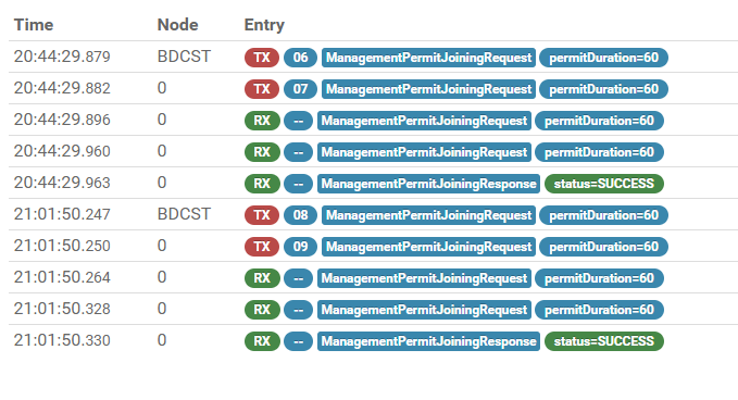

I just activated debug logging for the zigbee binding and will try a few things and give it a look then.
Here is the log from openhab2.log since restarting service and activation of debug logging.
I newly tried to scan for new devices and also took an eurotronic spirit to join-mode.
I am not used in reading such logs but i cant see that there is something wrong, just that there seems to be no reaction from the eurotronic that is logged?

Using the zigbee log viewer it appears to me the coordinator shows a successful join but the Spirit does not get the message. Perhaps factory reset the device?
https://www.cd-jackson.com/index.php/openhab/zigbee-log-viewer
You´re sure? But nothing shows up in the inbox and the devices goes to “Err” (Error) on the display after 1 minute of searching.

Just playing around with setting zigbee to discover devices, i ran into an fact i did not register before:
2020-01-05 00:58:47.327 [DEBUG] [zigbee.transaction.ZigBeeTransaction] - Transaction state updated: TID 1D → RX_ACK == COMPLETE

As you can see there are lines which show that something with RX_NAK is failing. Your Log Viewer shows nothing if the filters checkboxes aren´t checked, but when this is the output:
grafik
I double checked this and the log is always the same when i trigger a Search for Devices in the Inbox for the Zigbee Binding.
And here the new fact: Its always the same output whether there is any Zigbee Device in Joining mode or not! (Even if the batteries of the Eurotronics are removed!)
So I guess there isn´t any Problem with the Zigbee devices i am trying to connect but like an communication Problem with the Bitron Coordinator.
Wouldn´t this change your mind where to search for Problems? I read a few Threads where there are Problems with the eurotronics and zigbee, but they always seem to have their devices in their inbox which i don´t have.

But the fact that there is no difference in log between just triggering a discover without any zigbee device reachable (batteries removed!) or triggering a discover with device reachable is something i wanted to be mentioned in the thread just if anyone else is running into that problem (in the future).
