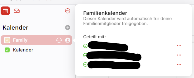

If have explicitly shared the calender with my family members and I’m scared that I have to redo the whole setup once I change this. I can’t simply change it to public with a switch.
