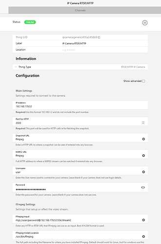

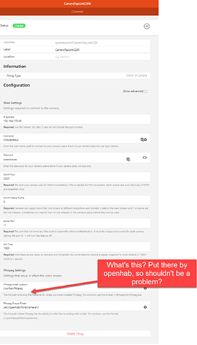

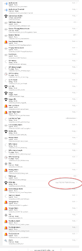

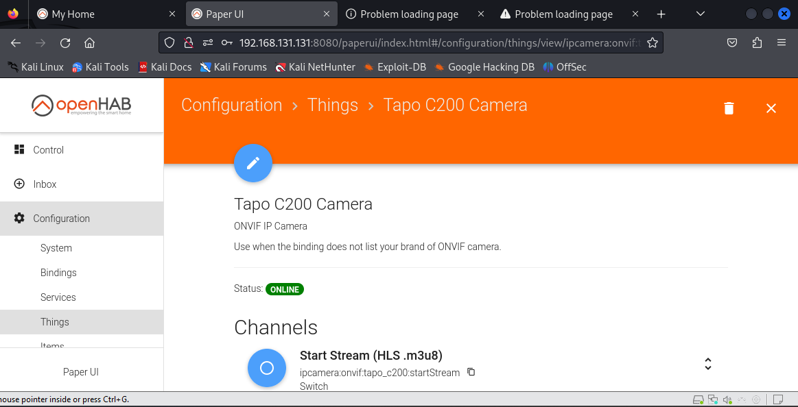

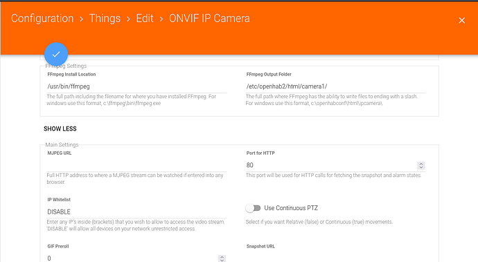

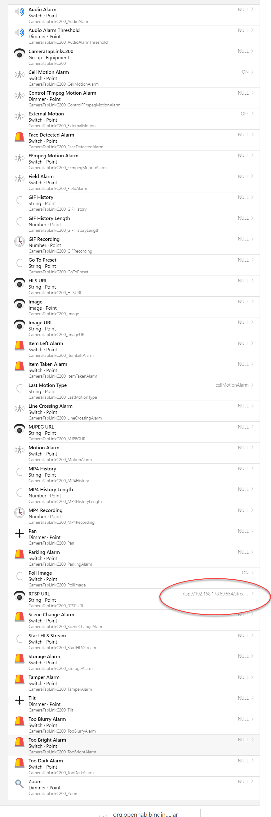

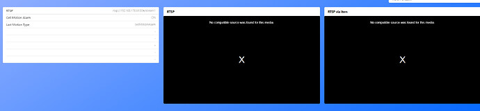

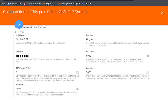

I installed the IP-camera-binding and installed a Tapo C200 which is supposed to support onvif. After some struggling, I managed to create the thing and it’s shown as online (settings: 1st screenshot). Then I added items for all channels that were available. However only very few of them show something other than NULL (2nd screenshot). At least RTSP URL shows the correct address. I know it’s correct because I it works with VLC where the stream is shown.
However, when I try to use this address or the item in a ‘video card’, no stream is shown (3rd screenshot).

  • Can I get the other items filled with data too? Or are they not supported by my camera and the channels/items are shown for every camera anyway, no matter if they support them or not?

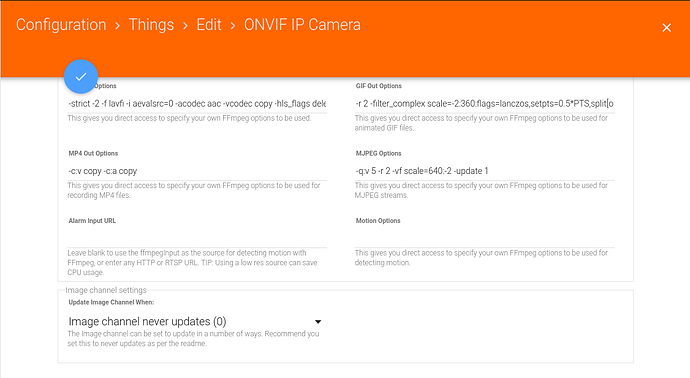

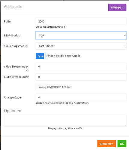

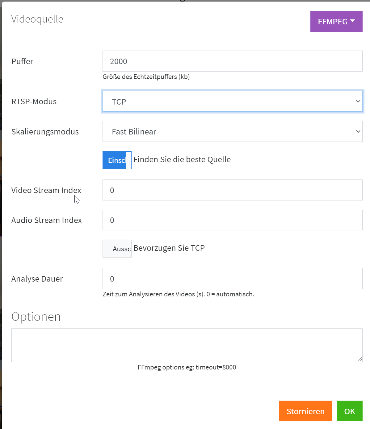

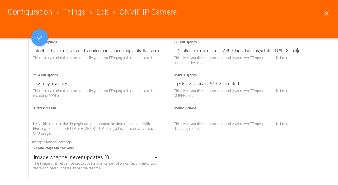

  • What are the FFMPEG-settings good for? If they’re of any use, what should I enter there? (4th screenshot shows FFMPEG settings from iSpy, but I haven’t changed them yet)
The problem was that I hadn’t installed ffmpeg. For others with similar problems:

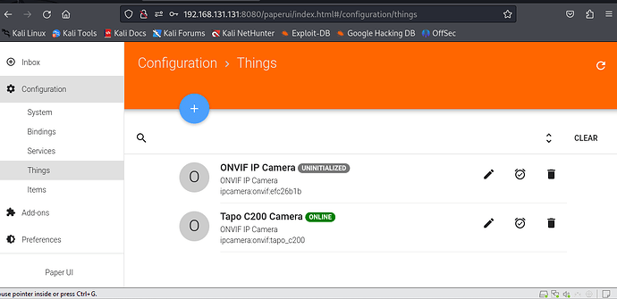

Need help please! I got this message when installing a Tapo C200 camera. I got this message “Status: OFFLINE - CONFIGURATION_ERROR Camera failed to report a valid Snaphot and/or RTSP URL. See readme on how to use the SNAPSHOT_URL_OVERRIDE feature.”
Also the camera that is installed and says online (Tapo C200 Camera), I cannot access the stream.
Does it need to be ONVIF?

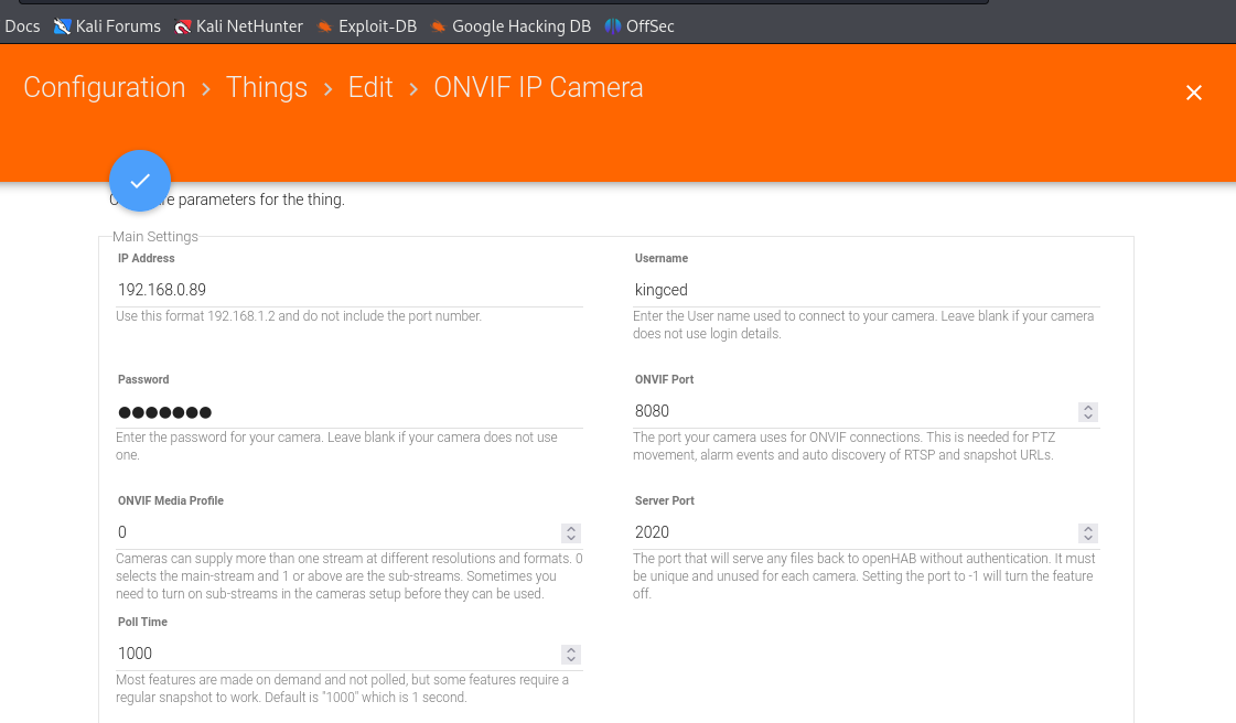

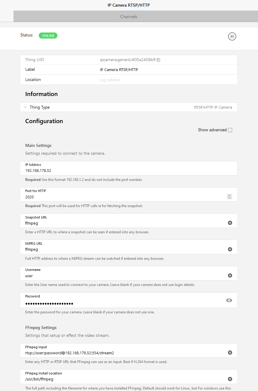

I installed my C200 as RSTP, pls find parameters below.

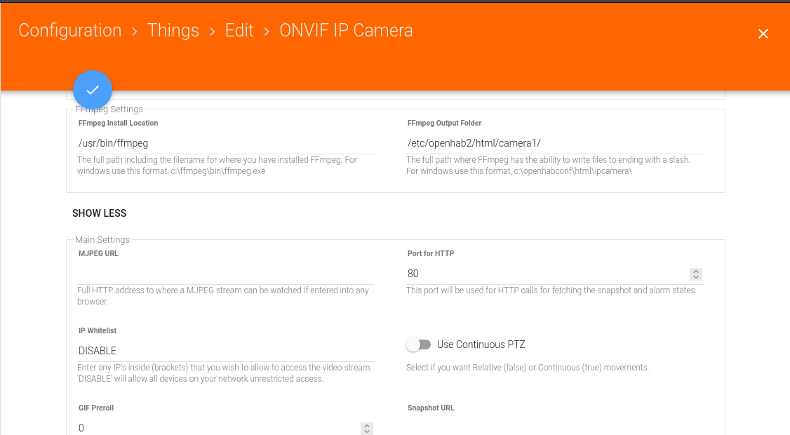

(According to your screenshots, your openHAB version seems to be very outdated, you may also update OH…?)
You also need to install ffmpeg:
sudo apt update && sudo apt install ffmpeg
It needs to be onvif if you want events like motion detection and other features that are explained here:
That is explaining the situation very clearly to me, does this not make sense? If so how can it be re-worded so it is clear?
Test the camera in another program like ‘onvif device manager’ and does it auto detect the snapshot and RTSP urls? If a second program does not then contact your camera support for an updated firmware.
