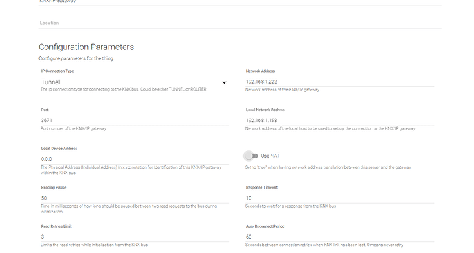

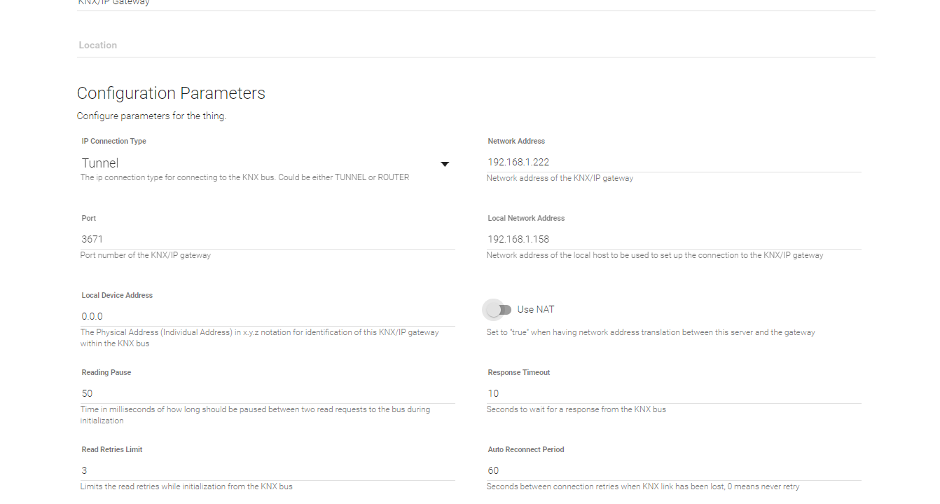

Well, the individual address of the bridge must be an unused one, NOT the individual address of the knx interface.
Okay, thank you very much for the clarification. So I have to set the bridge to an unused device address like 99.99.99 and set the knx device to the address of the actuator?
Simply set the IP interface to 0.0.0.
At the switch actuator thing set the actual address to the device address on the bus (e.g. 1.1.2) as defined in ETS and select your interface in the bridge selection.

Please be aware that 99.99.99 is not an allowed individual address at all, as the scope is 0 to 15 for the first and the second part and 0 to 255 for the third part. Please be aware that 0 has a special meaning in all three parts. The individual addresses are not simply “set 16 bits as you want”. If you’re only using knx but don’t change settings through ETS, don’t think about individual addresses at all, just don’t set localSourceAddr at all or set it to “0.0.0” as suggested by @Oggerschummer
In question of the Things, you can keep it simple and just use one generic thing without any configuration (no address, no fetch, no pingInterval, no readInterval), then just add all your channels as channels and link them to the corresponding items. Or use the “one thing per device” option. Then if setting the correct address and pingInterval!=0 (maybe 300) you will get information about the ONLINE status of the device, but to be honest, this information is not that useful when using knx TP (twisted pair), it may be a nice feature when it comes to knx PL (power line) or knx RF (radio frequency), I don’t know as I only use TP.

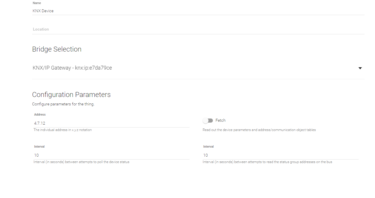

Okay, thank you both very much. Here is the setup how I have it:
I still cant get it to work… Is there anything configured wrong?

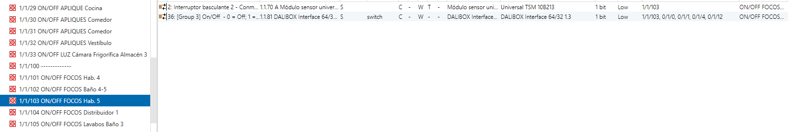

In your last posting, the openHAB knx channel should be [ ga="1/1/103" ]. A better view would be the one from the actuator (right window is all KOs from the actuator with all set GAs).
DALI is a bit special, because there might be no sufficient GAs for individual dimmers (depends on the configuration and DALI gateway…) I have no DALI…
Do you have some simple switch actuators? That would be a nice point to start.
