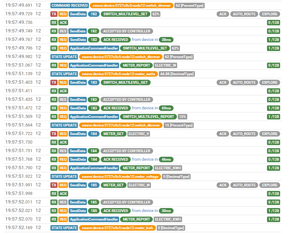

I was hoping this would sort out my issue with the dimmers “changing” status back, every time I’m changing it remotely.
received command 62
predicted to become 62
changed from 15 to 62
changed from 62 to 15
(lights actually changes ands stays 62%)
(Manually dimming does rapport correctly)
Anything obvious I should be looking in to? Or could it be more issues with the entry?

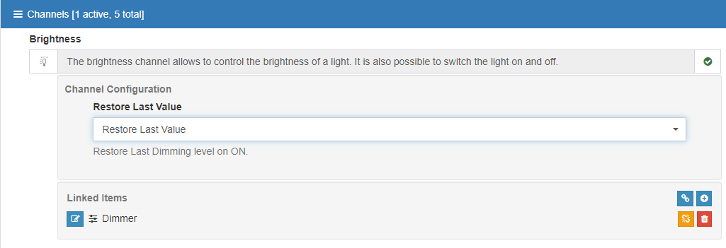

Try setting the “invert percent” value in you channel config.
I’m not OP, but I can confirm that there is no “invert percent” alternative in the brightness channel config. There is only the “Restore Last Value” parameter, with the alternatives “Restore Last Value” and “Restore Full Brightness”. Out of curiosity, why do you suspect “invert percent” could help?
From the log, it looks like the controller sends a SWITCH_MULTILEVEL_SET command with 62%. This is received by the device, which proceeds to set the dimmer value correctly (the lights actually do change to 62% brightness), and then it ACKs the command. The binding proceeds to set the value of the channel, and the associated item, to 62%. About 1.5 seconds later the controller sends a SWITCH_MULTILEVEL_GET command to the device, and the device ACKs the command and reports a value of 15%. This value is wrong.
More generally, what happens is that after the controller has sent its SWITCH_MULTILEVEL_SET command, it sends a SWITCH_MULTILEVEL_GET command, and the value received through the latter is not actually the correct current dimmer value. It is the dimmer value that the device was last set to with physical manipulation of the device. So you turn the dimmer wheel to X percent, then X percent is what the dimmer will send as its response to SWITCH_MULTILEVEL_GET until the dimmer wheel is turned to some other value.
So this looks to me like a hardware bug in the device. A potential workaround that I’m not sure is possible is if OH did not send a SWITCH_MULTILEVEL_GET command after it has sent a SWITCH_MULTILEVEL_SET command. Is this something that is configurable in the zwave binding on a per-device basis?

In any case, “invert percent” doesn’t seem to be an alternative on the channel configuration. But setting “Command Poll Period” to disabled looks like the workaround I had in mind! Thanks. :slight_smile: Although the regular polling will probably mess up the value whenever it’s triggered, so I’m guessing the problem is not completely worked around even with this.

Not polling is not a solution to the device reporting the wrong value when being polled. It is a workaround because the problem still exists, it is just being worked around to make it have less of an impact. If it is polled, it will still report the wrong value, and this problem prevents successfully polling the device either for confirmation, or after resetting OH, or after a power outage, or for any other reason where a poll is appropriate. If this is indeed a bug in the device itself, the only solution is to get firmware fix or a replacement.
