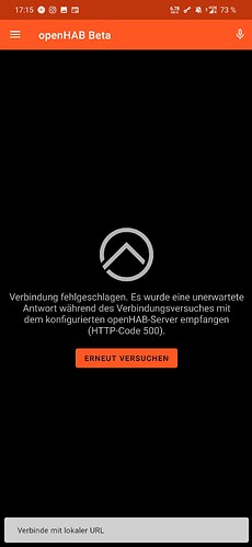

I found a strange behavior with the OpenHAB App for Android: I can’t use it. It shows an Error as you can see below

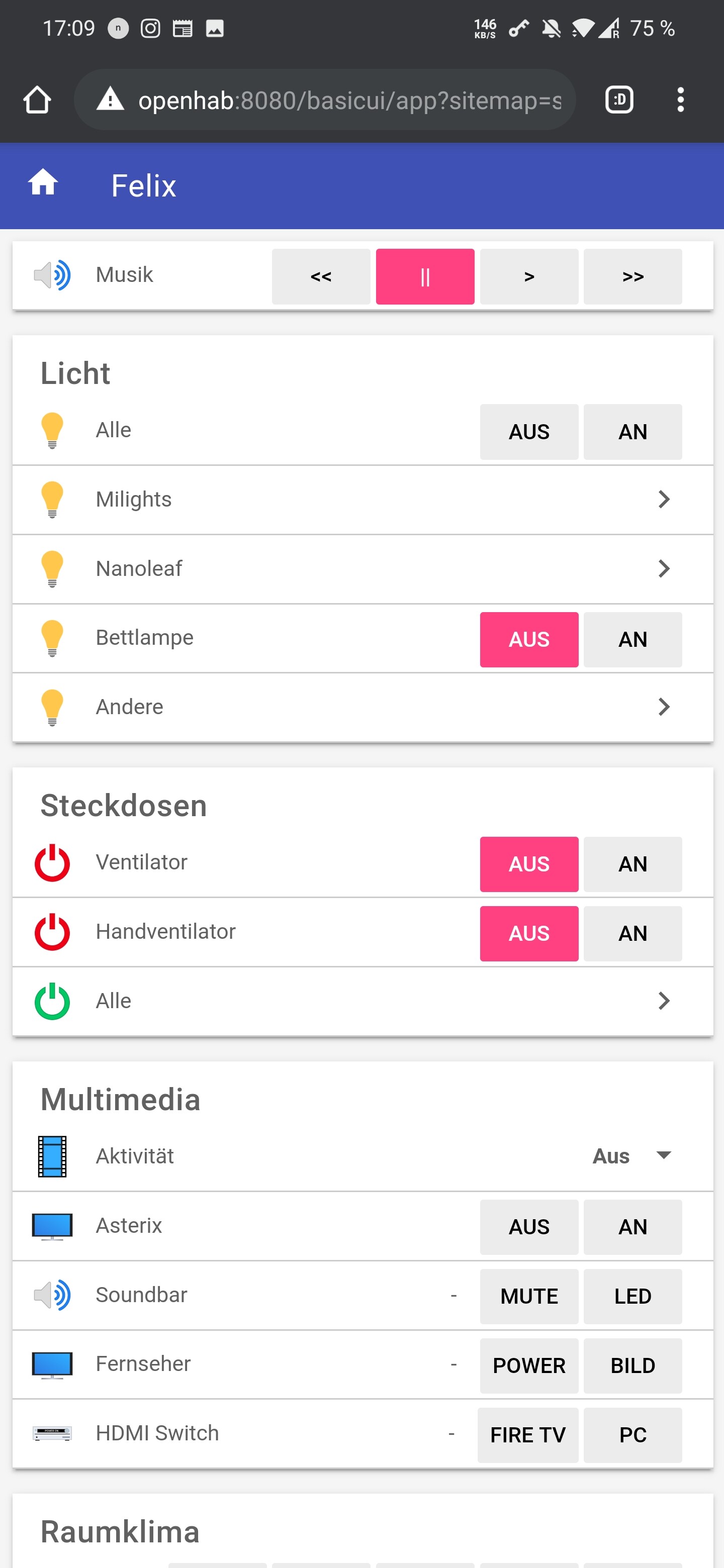

  • connect to openhab via Google chrome and open the sitemap
  • open grafana on port 3000
  • access everything just normal via chrome on port 8080

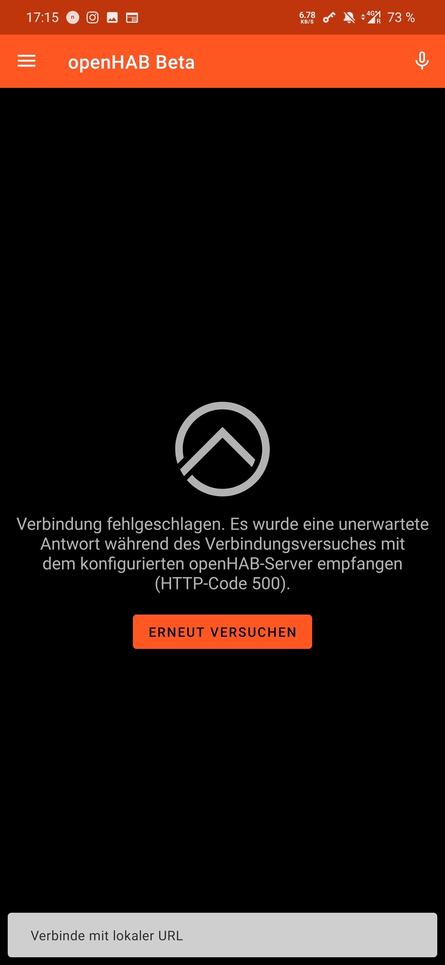

In the screenshot you can see on the bottom that it trys to connect to openhab. However openhab does have a problem as error code 500 means internal server error.
There are no log entries in either logfile regarding this issue.

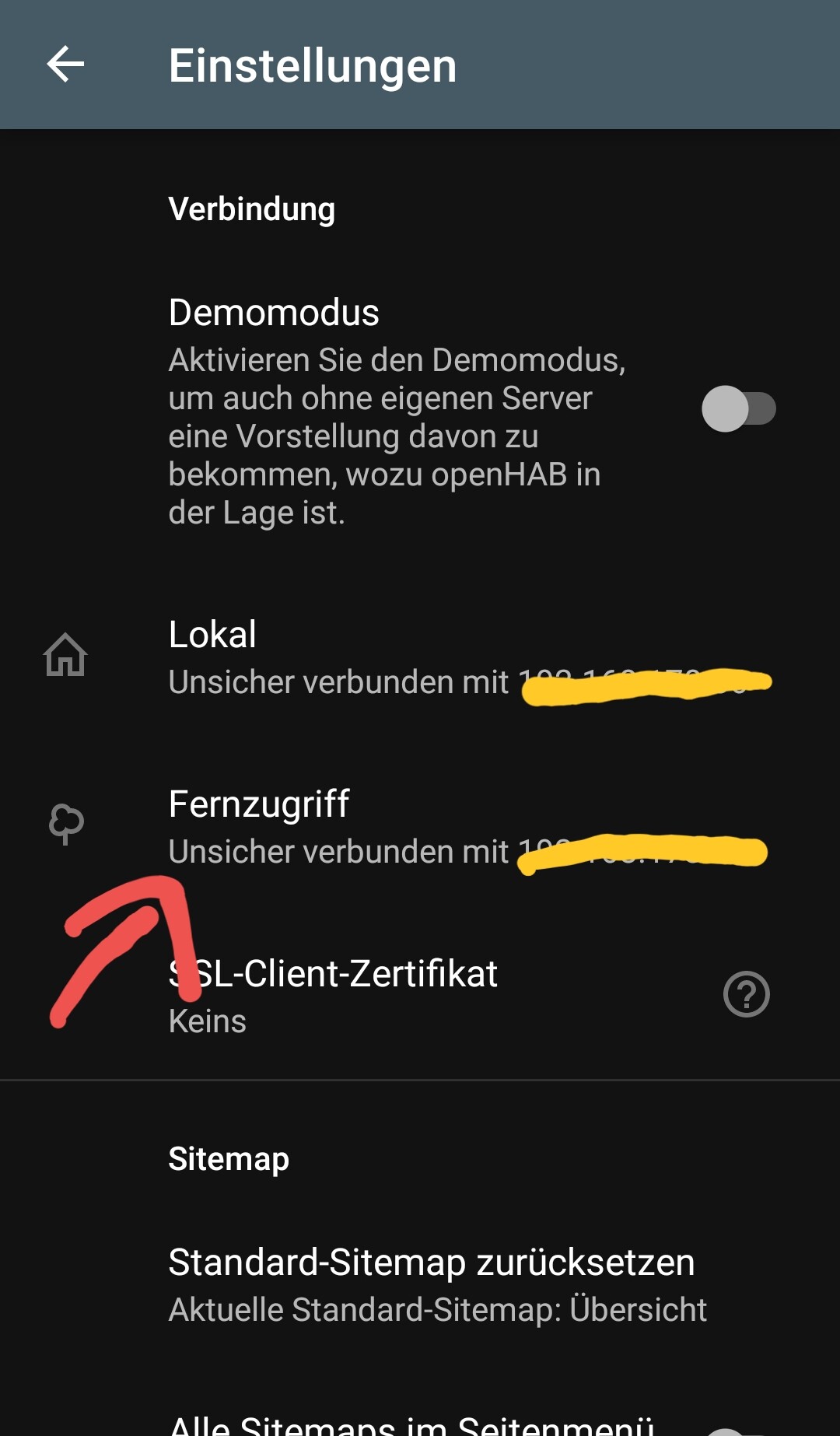

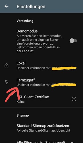

You have to configure an own ip for remote access via vpn in the app :upside_down_face:
Where can I set the IP? I cant find the setting
We are talking about the IP of the smartphone, not the one of the OpenHAB server, right?
Go one Menu back
The Menu-Entry is called “Fernzugriff”
I have configured here the same IP as at the local entry
I see… That’s where I put in the myopenhab details…

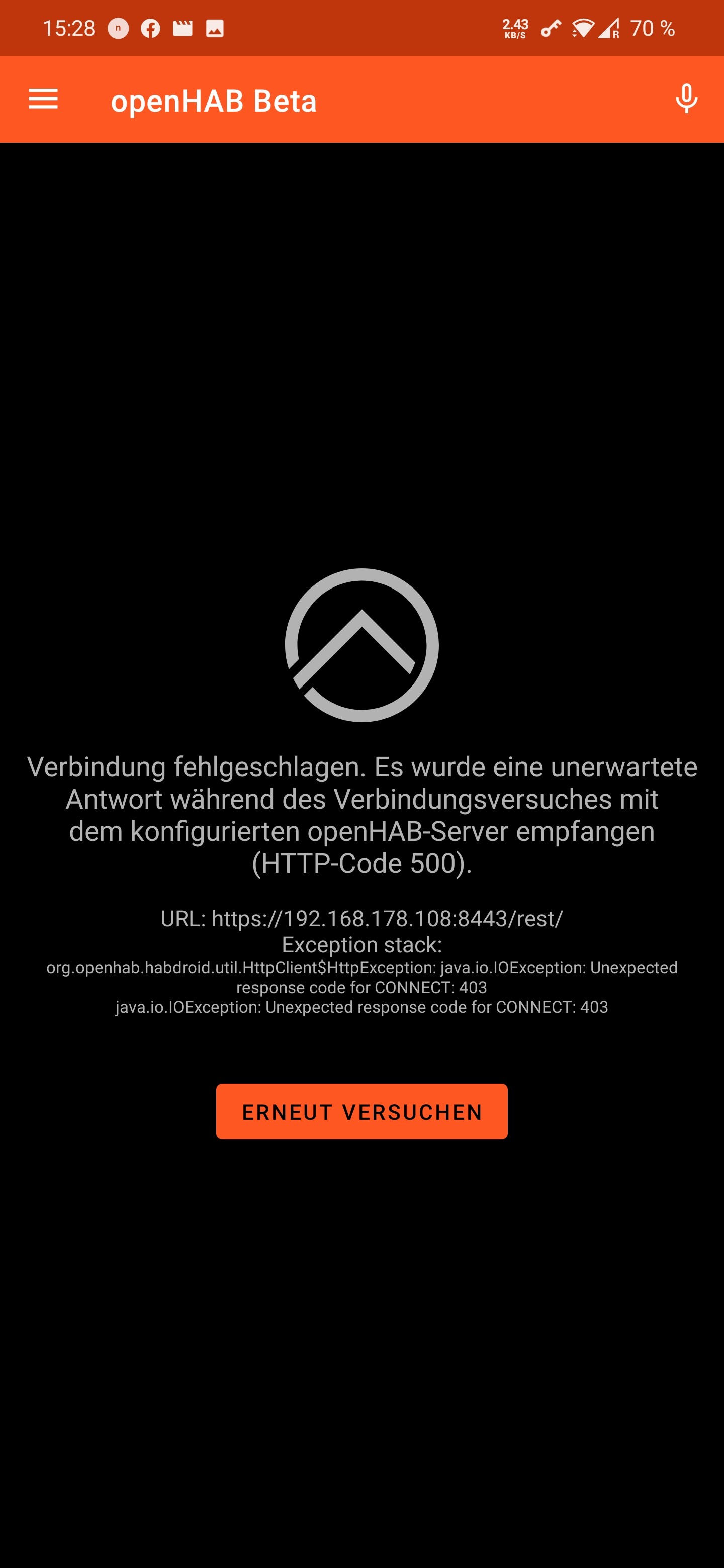

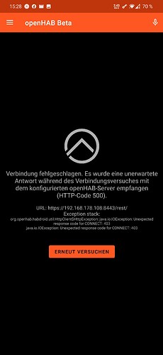

@Felix_Schneider Can you post the log of the app when trying to connect over VPN? Please turn on debug logging before trying (“Erweiterte Fehlermeldungen”).

The log file is too long to paste in so here it is:
untitled.txt (56.2 KB)
For testing, does using http on port 8080 work any better? The stacktrace points towards some HTTPS-to-HTTP proxying going on.
Yes port 8080 works (with VPN).
However it says that is using the Remote-URL. So I changed the email address in the “Fernzugriff”-Settings and then it didn’t work. So the connection works however it is via the internet which is kind of pointless when using a vpn.
It is no problem for me as the connection via the cloud works just fine but for someone who want to use the vpn for access from outside the LAN this might be problematic.
I assume the quoted part is for the broken https case? If so, it makes sense: the app will try the local connection via VPN first (but gets error 403), and as next fallback tries the remote connection. If the local connection via VPN works it will use just that (I happen to use the app that way).
So https local access works in the local WiFi? If yes, the problem resides somewhere in the server, which for some reason sends HTTP response 403 (forbidden) in the VPN case.
Yes https access ( I assume this is given by port 8443) works. So the problem is that the vpn local connection doesn’t work. Any idea on how to fix this?
