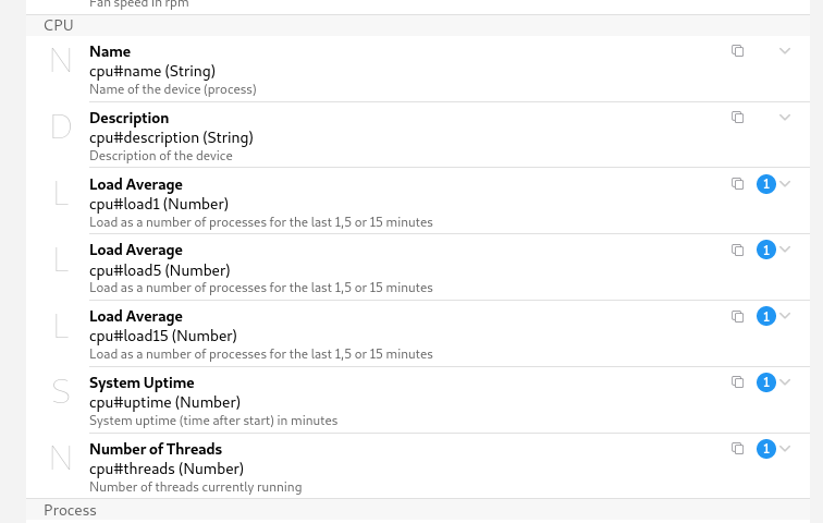

While being away for a few days, openHAB got into troubles. The maximum threads for openHAB has been reached, while the memory was still sufficient..
Reading the log files, I assume that there is a problem within the gardena binding.
The messages seem to correspond to the number of active threads.
It started very slowly but than the frequency incresed a lot.

Hi @usambara, how did you get the info for that chart? Which binding did you use? I had a similar issue (but don’t have gardena) but don’t have a place to see threads over time. Thanks
it’s from the systeminfo binding:
Number num_Server_CPU_Threads "Number of Threads [%d]" {channel="systeminfo:computer:kopf:cpu#threads"}
I’ve got that binding but for some reason that channel is not there, doesn’t exist. I haven’t done file configs, have been using the UI. In theory it should be possible to configure all through the UI, but it seems reality is different.
I think you need to enable "show advanced on the top right of the channels.
