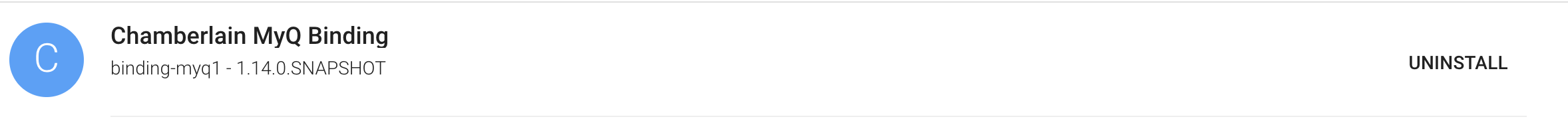

To add to this, in the Kara console I see 2 myq bindings active even though there is 1 in my adding folder. Did I install the binding incorrectly?
14%20PM
My guess is that you installed one from the PaperUI and then copied the new binding to the addons folder. If that is the case you should delete the one from the addon folder, then using the PaperUI remove the other one. Restart Openhab and copy the new binding to the addon folder. Please post if you can then connect as it looks like some people are having issues getting the new binding to work.
I did what you said and confirmed in the Karaf console that only one binding is loaded (the 20191022 version).

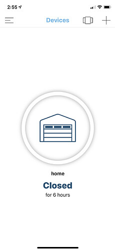

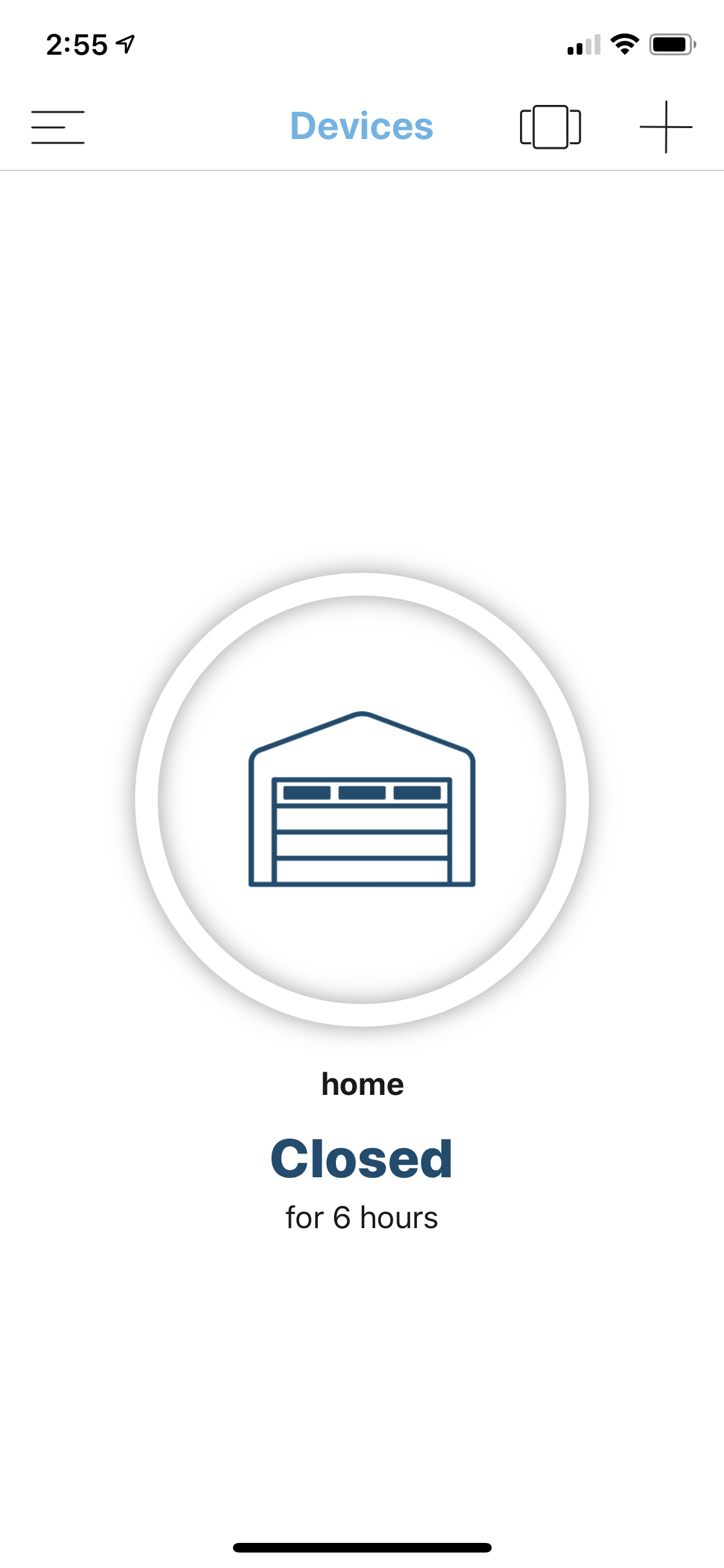

Below is a screenshot from the MyQ app:
When i change the state of the GarageDorrSwitch or the GarageDoorShutter, i see the change in the logs but nothing happens. Then, about a minute or 2 later this message comes up in the logs:
2019-10-29 14:54:17.068 [WARN ] [org.apache.karaf.services.eventadmin] - EventAdmin: Exception during event dispatch [org.osgi.service.event.Event [topic=openhab/command/GarageDoorShutter] {item=GarageDoorShutter, bridgemarker=true, command=UP, timestamp=1572374513728} | {org.osgi.service.event.EventHandler}={service.id=449, service.bundleid=271, service.scope=bundle, refresh=30000, component.name=org.openhab.binding.myq.binding, component.id=279, timeout=25000, password=PASSWORD, quickrefresh=2000, event.topics=openhab/command/*, username=USERNAME, appId=NWknvuBd7LoFHfXmKNMBcgajXtZEgKUh4V7WNzMidrpUUluDpVYVZx+xT4PCM5Kx, service.pid=org.openhab.myq} | Bundle(org.openhab.binding.myq_1.14.0.201910221119 [271])]

I’m getting:
2019-10-29 19:54:52.672 [ERROR] [nhab.binding.myq.internal.MyqBinding] - Could not connect to MyQ service
java.io.IOException: Could not parse response
	at org.openhab.binding.myq.internal.MyqData.request(MyqData.java:286) ~[304:org.openhab.binding.myq:1.14.0.201910221119]
	at org.openhab.binding.myq.internal.MyqData.login(MyqData.java:138) ~[304:org.openhab.binding.myq:1.14.0.201910221119]
	at org.openhab.binding.myq.internal.MyqData.findAccount(MyqData.java:184) ~[304:org.openhab.binding.myq:1.14.0.201910221119]
	at org.openhab.binding.myq.internal.MyqData.getAccountID(MyqData.java:207) ~[304:org.openhab.binding.myq:1.14.0.201910221119]
	at org.openhab.binding.myq.internal.MyqData.getMyqData(MyqData.java:121) ~[304:org.openhab.binding.myq:1.14.0.201910221119]
	at org.openhab.binding.myq.internal.MyqBinding.poll(MyqBinding.java:205) [304:org.openhab.binding.myq:1.14.0.201910221119]
	at org.openhab.binding.myq.internal.MyqBinding.access$0(MyqBinding.java:197) [304:org.openhab.binding.myq:1.14.0.201910221119]
	at org.openhab.binding.myq.internal.MyqBinding$1.run(MyqBinding.java:388) [304:org.openhab.binding.myq:1.14.0.201910221119]
	at java.util.concurrent.FutureTask.runAndReset(FutureTask.java:308) [?:?]
	at java.util.concurrent.ScheduledThreadPoolExecutor$ScheduledFutureTask.access$301(ScheduledThreadPoolExecutor.java:180) [?:?]
	at java.util.concurrent.ScheduledThreadPoolExecutor$ScheduledFutureTask.run(ScheduledThreadPoolExecutor.java:294) [?:?]
Caused by: org.codehaus.jackson.JsonParseException: Unexpected character ('<' (code 60)): expected a valid value (number, String, array, object, 'true', 'false' or 'null')
 at [Source: java.io.StringReader@10ccd2e; line: 1, column: 2]
	at org.codehaus.jackson.JsonParser._constructError(JsonParser.java:1432) ~[?:?]
	at org.codehaus.jackson.impl.JsonParserMinimalBase._reportError(JsonParserMinimalBase.java:385) ~[?:?]
	at org.codehaus.jackson.impl.JsonParserMinimalBase._reportUnexpectedChar(JsonParserMinimalBase.java:306) ~[?:?]
	at org.codehaus.jackson.impl.ReaderBasedParser._handleUnexpectedValue(ReaderBasedParser.java:1192) ~[?:?]
	at org.codehaus.jackson.impl.ReaderBasedParser.nextToken(ReaderBasedParser.java:479) ~[?:?]
	at org.codehaus.jackson.map.ObjectMapper._initForReading(ObjectMapper.java:2761) ~[?:?]
	at org.codehaus.jackson.map.ObjectMapper._readMapAndClose(ObjectMapper.java:2709) ~[?:?]
	at org.codehaus.jackson.map.ObjectMapper.readTree(ObjectMapper.java:1533) ~[?:?]
	at org.openhab.binding.myq.internal.MyqData.request(MyqData.java:252) ~[?:?]
	... 14 more
With the newest 1.14 binding. I’m about to give up on MyQ and go with something else. Anybody have any ideas?
