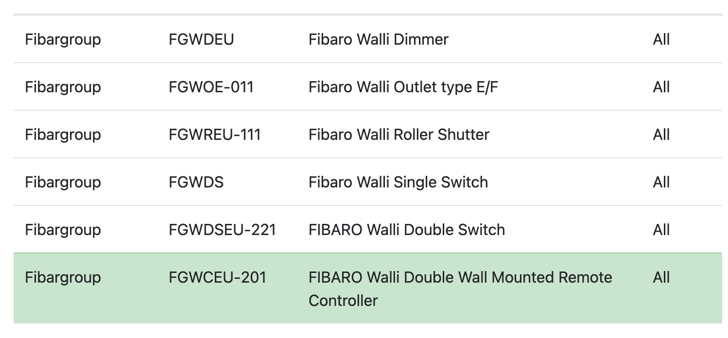

The device can be found here: OpenSmartHouse Z-Wave Device Database
How do I configure let’s say parameter 11 to become a channel to set the LED FRAME COLOR (when on)? I am happy to work on that.

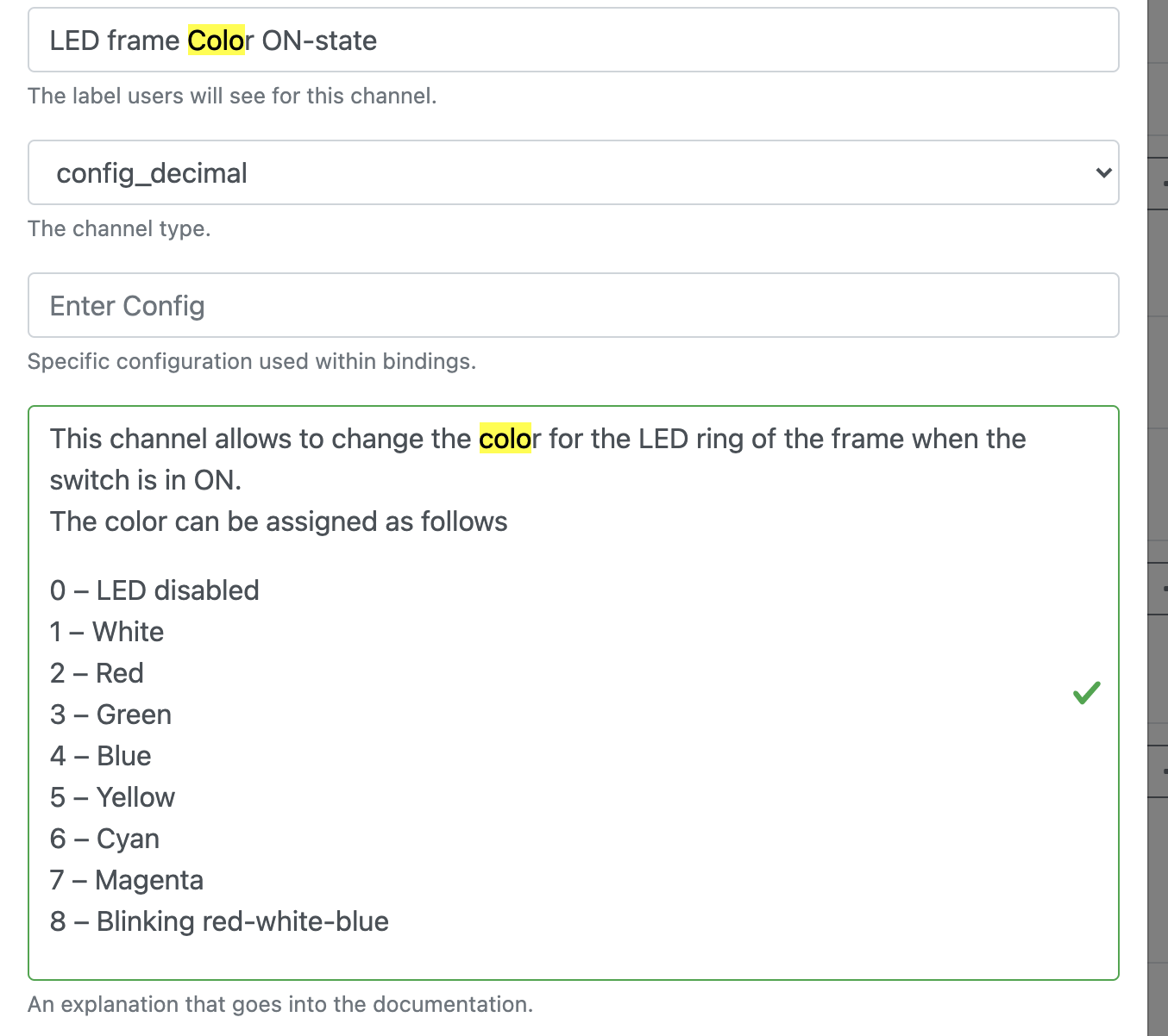

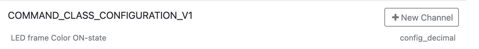

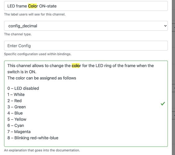

I have a question though: I have started editing the the channel as a command_configuration_class_v1
which opens a dialog allowing me to enter the following fields:
Unfortunately the options-field is missing. Any idea, why?
And can you explain what the “specific configuration used within bindings” is used for?

You can’t set options on the channel - the options should be on the parameter so that they are available in the configuration UI. The config channel simply takes a number - not the text.

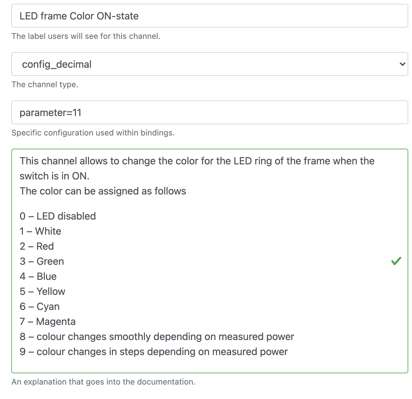

I just had a look at the database, and you need to add the parameter number into the config box as above. I guess it’s parameter 11 that you’re looking at?
Yes, it is. I will do so right away.
For the record, this is the final definition (note that the options had already been defined with the parameter 11)
I also added another channel for config parameter 12 and 13.

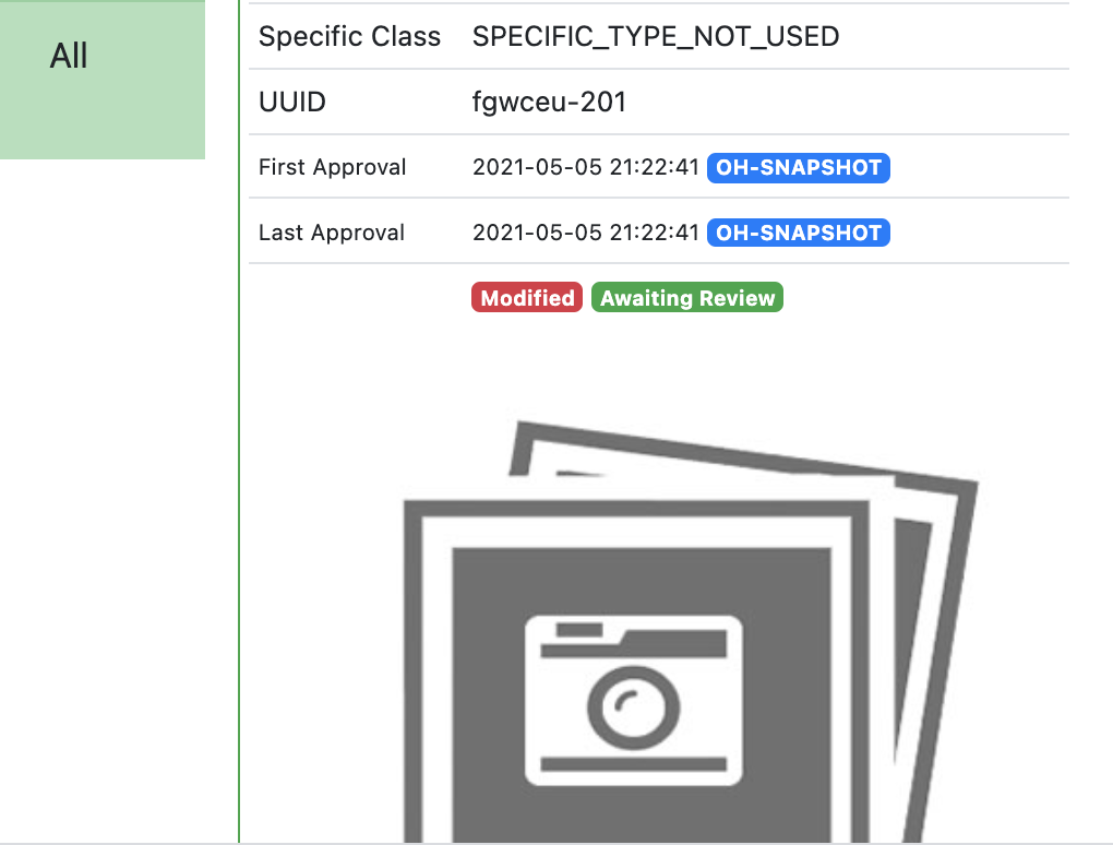

Can you check why the image of the last one seems to be broken in the database?
