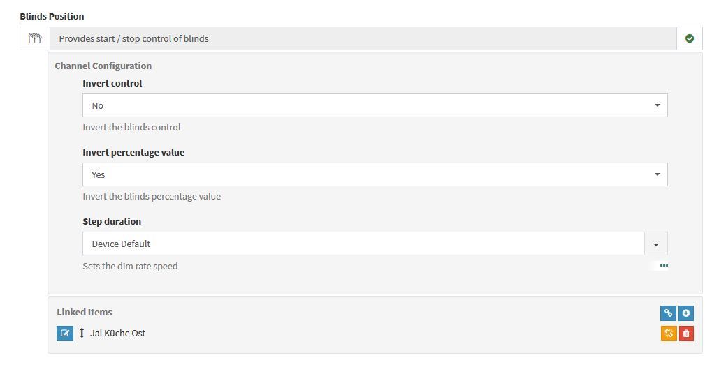

Another example of a channel with additional configuration parameters is from one of my Z-wave devices where it is possible to invert the feedback position and control direction in HABmin but I do not know how to do this in textual configuration in .items file.
Textual config is only possible with the zwave testing binding:
But I haven’t found any example for that either …
Not quite. Textual config of items is possible as it’s nothing at all to do with the binding. Text configuration of things can only be done in the development binding.
Almost: I have never found any hint how to add “invert control” or “invert percentage value” to my rollershutters items definition …
These are set through configuration parameters - I guess it’s the same as any other parameter configuration for any other binding as it’s definitely not read by zwave. You’d need to look in the source of the _channels.xml file to see what the naming is for the parameters.
