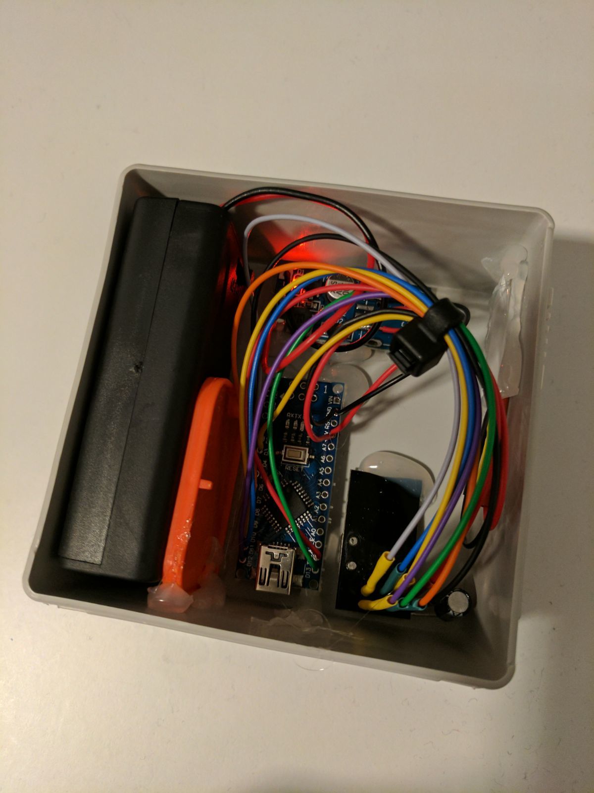

I use mysensors.org, here is my cheap (<20€) battery temperature and humidity sensor (80mmx80mm):

Do you mind providing a bit more information about the equipment you used for this?
of course not, the parts are:
  • ATMEL ATmega328P (Arduino Nano)
  • NRF24L01+ 2.4GHz Wireless Transceiver
  • DC-DC Step-Up 0.9-5V → 5V
  • DHT22 Sensor
  • 2xAA Battery-Holder
  • Case is a surface mounted socket
I’m using a second Set of Arduino Nano + Wireless Transceiver with a USB-Cable at the OpenHAB server (As serial gateway)
