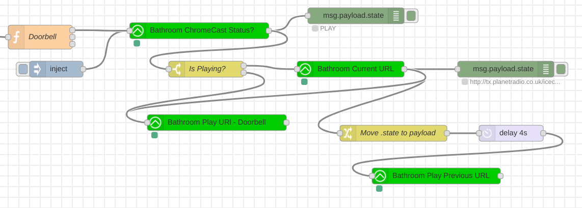

In case anyone comes looking for an option, I have just created a NodeRed flow that works for me.
