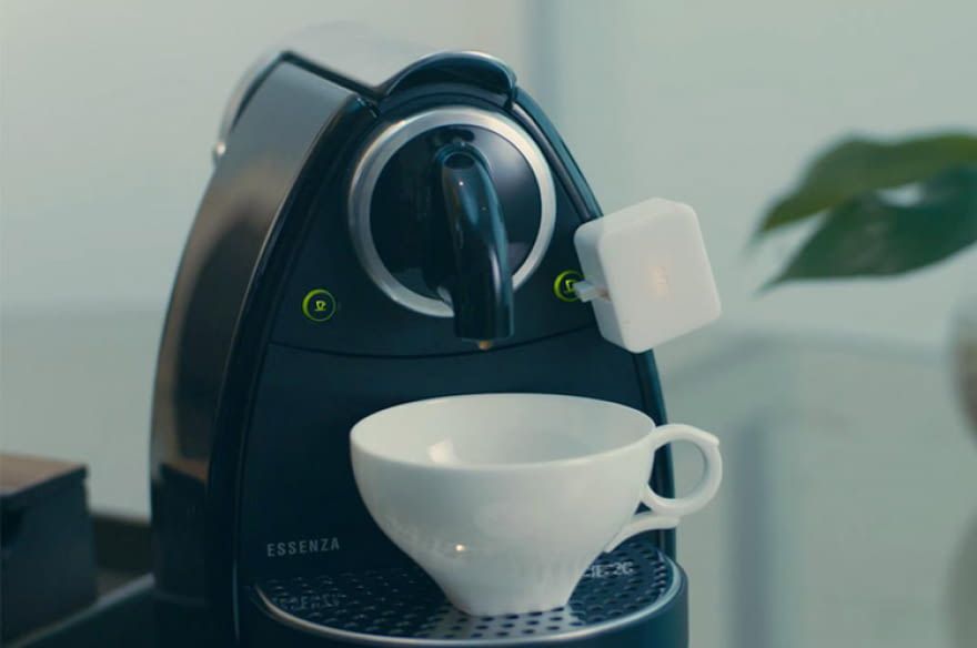

You can try to use a „switch bot“.
A little device which can turn on/off your machine.
E.g. discussed here:
And could be look similar to this:
