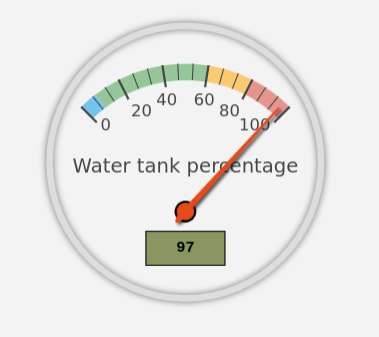

I will use that for my water tank percentage.
You can change the colors - red is probably wrong when the tank is full…
You can also reduce the “ticks” so that the “small lines” doesn’t indicate each 6.66. And for such a long title, you might want to reduce the font size a tad. If you add unit metadata to your Item, it will also show %.

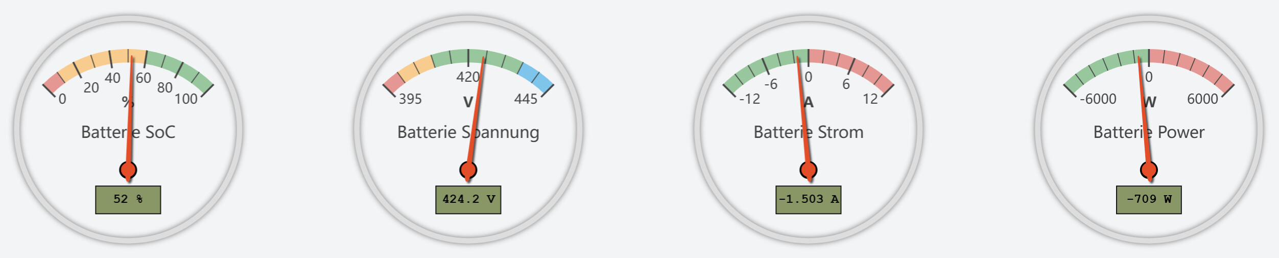

Ravi, thanks for this great widget. Here my use case for PV battery monitoring:

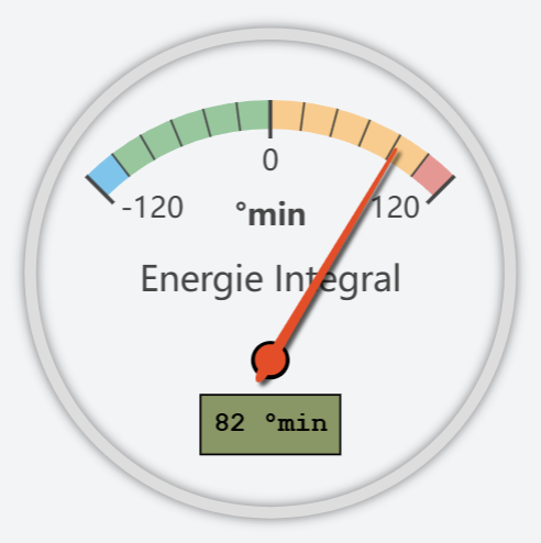

@Nadahar : have special problem today. Have a unit °min (energy integral) which is not part of openHAB’s UoM.
Could you help me with a special variant of your widget which probably adds °min as text instead of taking it from the item state?

@dk8pn In the widget code, there are several instances where the widget expressions include:
items[props.item].state.split(' ')[1]
These are all the places where the widget extracts the unit from the item state. To simply get your custom unit just replace each of those instances with
'°min'
If you are looking to make this more flexible, you could add a new property following the same format as any of the other properties (I would recommend using one of the ones with groupName: appearance as a template). Then you would need to replace the expression above with props.NAME_OF_YOUR_PROP and then you could set the unit using the configuration properties of the widget.
Many thanks for guiding me. Your hints did the job :grinning_face: .
