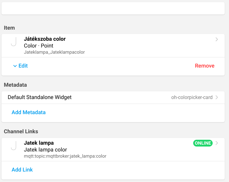

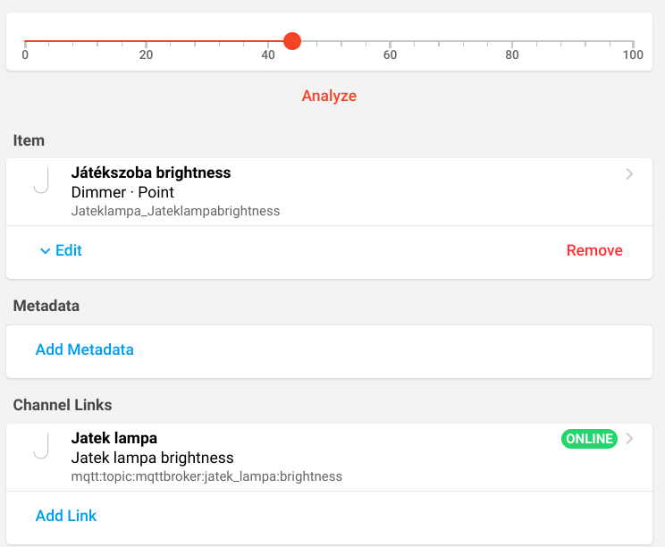

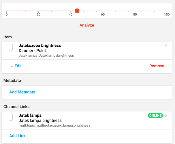

OK, so on OH3RC2, this is how a dimmer item looks like (and it is also working):

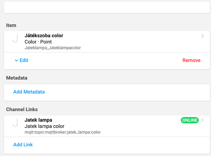

And this is how a Colorpicker looks like and it’s not working (there is a white bar that is not reacting to anything):
Go to Add Metadata → Select Default Standalone widget - > then change the widget from Default-OH to color picker card.

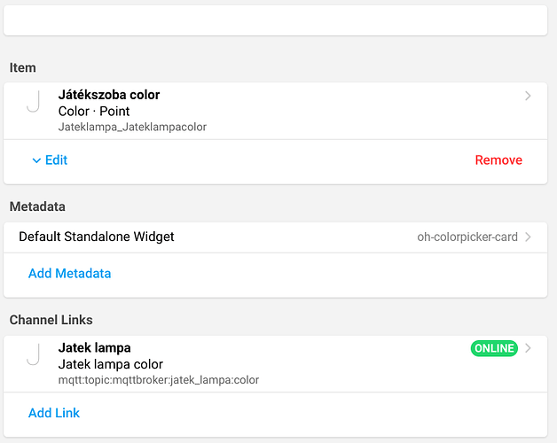

No joy, still that white box (I tried selecting colorwheel & RGB sliders in the Advanced properties as well but nothing changed):
ysc
(Yannick Schaus)
December 21, 2020, 5:22pm
8
Looks like a bug then… your item’s state is probably not initialized. Try doing openhab:send Jateklampa_Jateklampacolor "0,0,0" in the console and maybe the color picker will appear.
Z0l
(Zoltan Orosz)
December 21, 2020, 5:42pm
9
ysc:
openhab:send Jateklampa_Jateklampacolor “0,0,0”
Thanks, the colorpicker appeared after I initialized the item. How is this supposed to work with items that come and go (like lightbulbs)? Do I need a rule to assign the initial values when it comes online?
