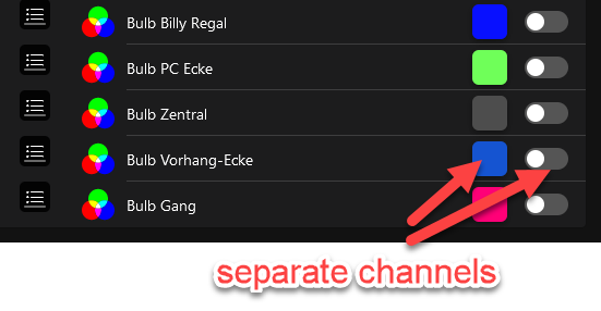

Hello
I am using a mystrom bulb. When I use a list with colorpicker-list-items, they all come with a color picker and a switch. This is nice, but the switch sends the On / Off command to the color channel. This is not of any use for me, since myStrom uses a separate channel for On and Off. Actually I’m not sure it this is really a good idea, how the standard colorpicker-list-item is implemented. It imho should offer a separate, configurable channel for On Off.
However, I quickly wanted to make my own widget for this. Since I couldn’t find it already, I’d like to share the final solution. Maybe someone else has use for this too.
It is quite raw - for example the color picker modules are hard coded, but you can extend it at your own needs.
